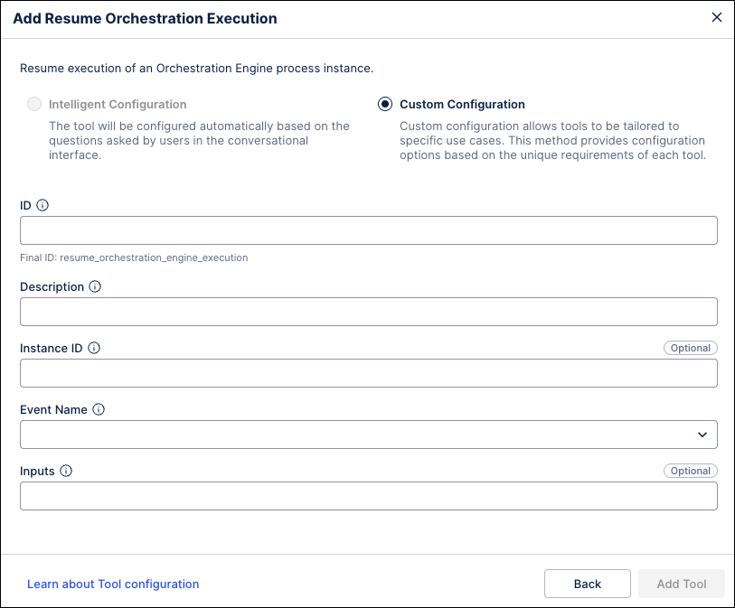

15. resume_orchestration_engine_execution — OE Resume
Mode: Custom only · Category: Other
Resumes a paused Orchestration Engine process instance.
- id: resume_orchestration_engine_execution
  unique_id: resume_approval
  description: Resumes a specific paused approval process.
  event_type: com.celonis.invoice.approval.resume
  instance_id: my-fixed-instance-id
  description: Resumes a paused approval process.
Field
Type
event_type
string
Required — event type key to trigger.
instance_id
string
Pre-set instance ID. If omitted, the LLM must supply it at runtime.
