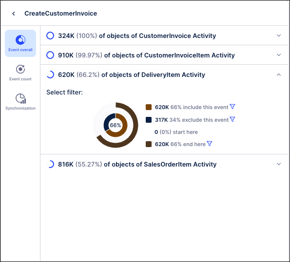

Event overall tab
The Event overall tab shows usage details for this event, such as how often this event occurred in other processes, what percentage of processes do not include this event, and how often this was the first or last event in a process.
The following metrics are available on the Event overall tab and can be used as filter criteria:
  • Objects that include the event
  • Objects where the event is excluded / doesn't feature in the process
  • Objects that start with this event
  • Objects that end with this event
Screenshot showing the metrics on the Event overall tab of the Event Explorer.

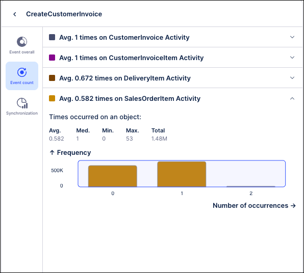

Event count tab
The Event count tab allows you to view the average number of times the selected event occurs in each of the event logs / processes. You can also filter to view only objects where an event occurs less or more times than a defined threshold.
Screenshot showing the metrics on the Event count tab of the Event Explorer.
