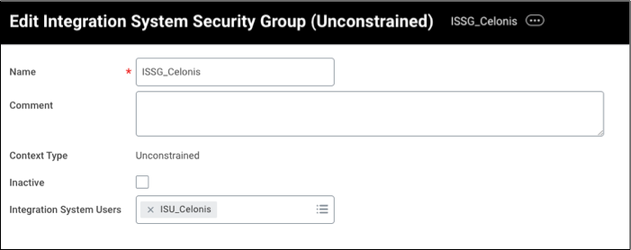

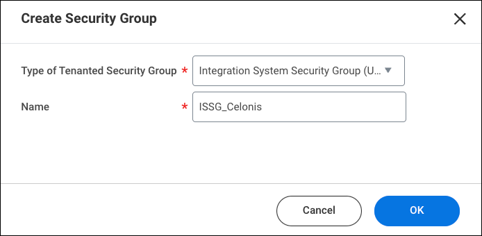

  1. Select Create Security Group task.
  2. As a type, select Integration System Security Group (Unconstrained) or Integration System Security Group (Constrained). The main difference between these is that constrained version results will only be returned for objects that have a connection with a constraint. For example, for workers in the US organizational entity only.
  3. In Group Criteria, select the newly-created ISU for inclusion in the security group.

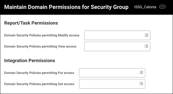

Identify required security needed for specific operations (View Security for Securable Item) and edit domain security policies.
  1. Select the Domain Security Policies for Functional Area report.
  2. Select a security policy.
  3. Select Edit Permissions.
  4. Grant Get access for specific domain to newly created ISSG.
  1. Access Activate Pending Security Policy Changes task.
  2. Select Confirm checkbox to activate your changes.
There are several ways to give the ISSG access to the domains - but the easiest way is to use the related actions on the newly created ISSG and Maintain the domain permissions for security group:

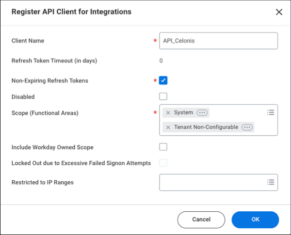

  • The security is double layered - the API Client must be given access to the functional areas and the integration user (security group) that was configured in steps 1-5 needs access to the specific domains. If the API Client has access to a functional area but the attached integration user does not have access to that area, then the API Client will not be able to access that data, and going the other direction if the integration user has access to data but the API Client does not have access to the functional area then the API client will not have access to the data.
  • We recommend Non-Expiring Refresh Token, it is misleading but the refresh token is assigned when an integration system user is linked to the API Client, so a non-expiring refresh token just means that the unique refresh token code will not expire. If the refresh token is set to expire it will need to be regenerated and updated in Celonis every time it expires. Note for non-expiring refresh tokens they can still be manually refreshed by the customer - and it has no impact on the ability of the API to refresh it’s authorization code.
  • We recommend all API Clients for Integration have access to System and Tenant Non-Configurable. System is required for WQL and Tenant Non-Configurable is required for RAAS.
  • Upon Registration - note down the Client ID and Client Secret - the Secret cannot be viewed again after this point so if it is not noted down a new client secret will need to be generated.

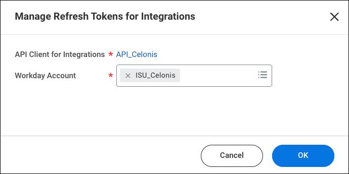

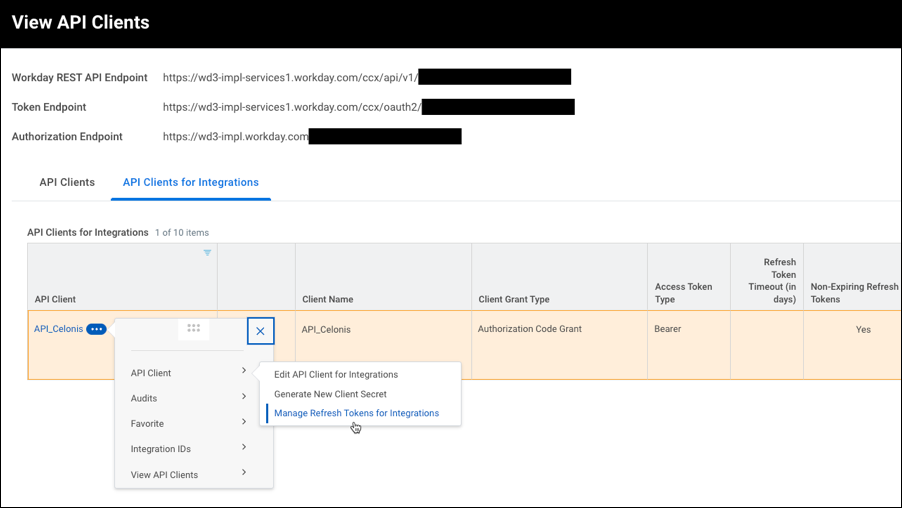

Navigate back to View API Clients - and find the API Client for Integration that was just created. On the related actions, select ‘Manage Refresh Tokens for Integrations’
Select/Link the Integration System User that was created in step 1.

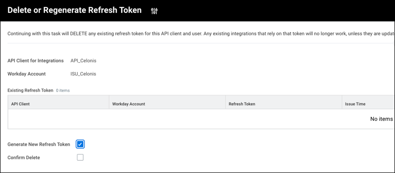

Select the Generate New Refresh Token option. Note if a refresh token already exists for this Integration System User on this API Client, then you will also need to Confirm Delete the existing Refresh Token - multiple Integration Users can be linked to 1 API Client, but each Integration User can only have 1 Refresh Token for each API Client.
