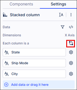

  2. Using the component settings menu - select the data and metrics you want to display in your chart.
    A screenshot showing how to create a chart in a studio view.
    Once data has been added, your chart preview will update in the View.

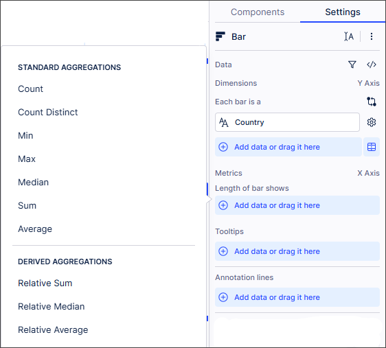

Data (dimensions and metrics)
This is where you control what data fields you want your chart to be based on. The dimensions controls what the bar, column, or pie slice is based on, whereas the metrics control how long or large they are in your chart.

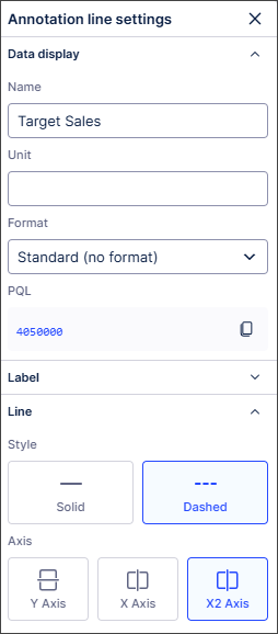

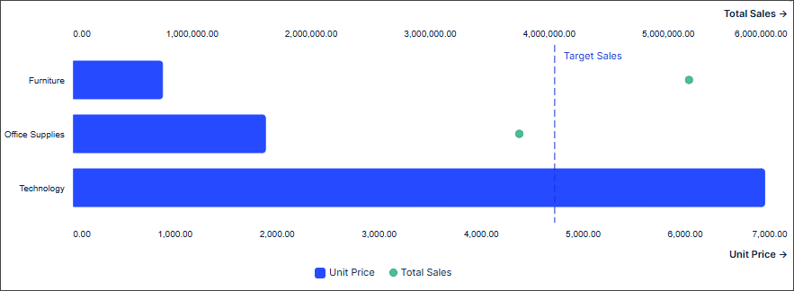

Annotation lines: Annotation lines are used to draw lines on the chart area. This can be useful for highlighting information such as a threshold. You can also choose to display your lines by name, value, or using both.

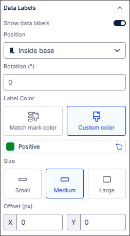

Chart data labels
You can add data labels to your chart metrics, allowing users to read the exact value per metric.
In this example, the data labels show the exact number of orders per city (Jackson has 82, Colombus has 81). The mark color is also matched to the metric color.
A screenshot showing an example chart within a studio view.
You can change the positioning and appearance of data labels using the Data Labels panel which is accessed from Metrics Settings.
From the Data Labels panel, you can:
  • Toggle data labels on and off.
  • Move the position of data labels, including rotating them.
  • Change the color of data labels and the color contrast.
  • Change the size of the text in data labels.
  • Change the offset of data labels (in pixels) to prevent overlap.
Chart data label positioning options

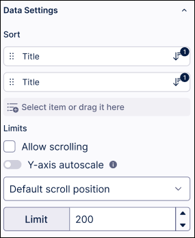

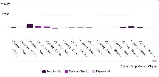

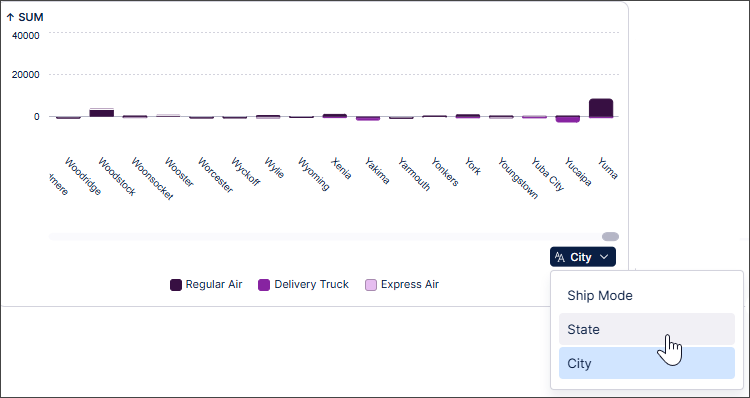

Chart sorting, scrolling, and chart entries limit
Choose how the columns in your table are sorted by selecting the data fields then choosing the order of sorting. The selected fields will be shown in a separate sorting section, allowing you to change the order in which multiple fields are sorted.
  • Allow scrolling: You can also allow scrolling through the chart limit the number of chart entries displayed. When allowing scrolling, you can select where the scrolling start position is by selecting between default, scroll from top, and scroll from bottom.
  • Y-axis autoscale: Enable autoscaling to adjust the Y-axis dynamically based on the visible data range, which can help when working with large spikes. When disabled, the Y-axis remains fixed to provide a consistent view of the entire dataset, ensuring smooth scrolling and easier data comparison.
