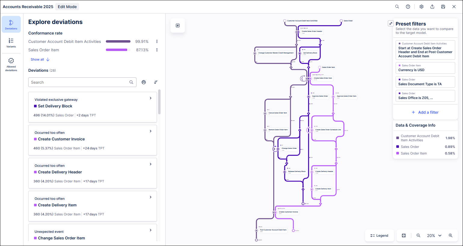

  2. Select deviations_button.png.
    The Explore deviations screen opens.
    Any filters you applied when creating your target model are displayed. You can remove or edit them here or add new filters.
    The Conformance rate shows the percentage of events in your process that conform to the target model process for each event log. If the Conformance rate is 100%, for example, your process conforms exactly to the target model.
    You can also copy the Conformance rate PQL query to the clipboard. You can then use it in a Studio View or as a KPI in the knowledge model.
  3. In Deviations, deviations display for all event logs, with each deviation including the:
    1. Deviation category.
    2. Event log and event where the deviation occurs.
    3. Percentage of cases across all event logs (weighted average) the deviation occurs in.
    4. Impact on the throughput time caused by the deviation.
    Click PAM_sort_button.png to sort deviations based on their impact on the displayed KPIs.

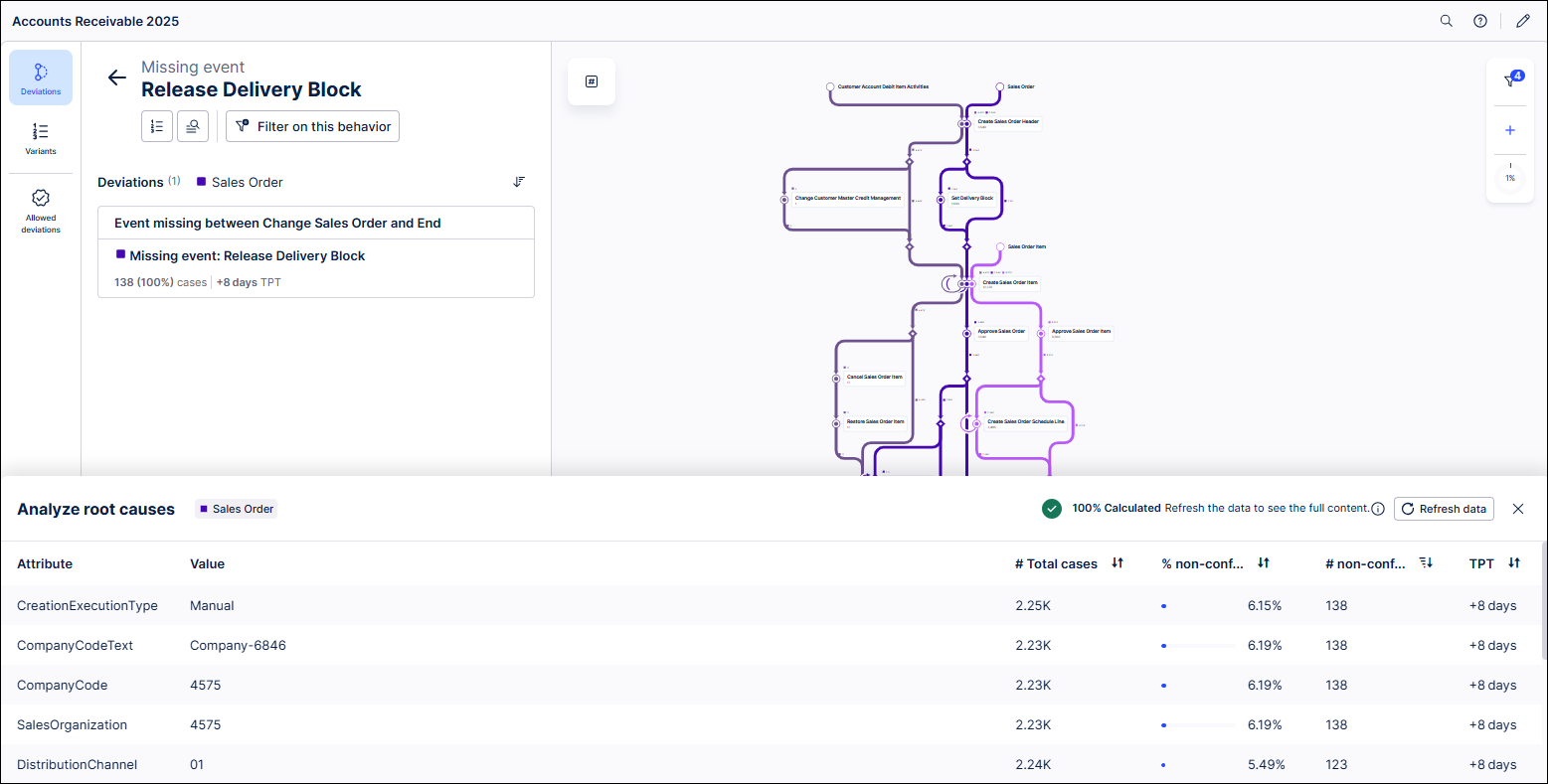

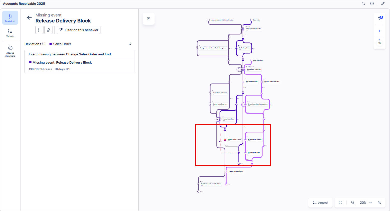

  4. Select any deviation to view more details about that deviation.
    The dashed line shows where the deviation occurs. Here, the deviation is a missing event.
  5. Select analyze_root_causes_button.png to analyze the root causes of the deviation.
    A table that displays detailed information about the selected deviation appears. You may need to select Refresh data to ensure all data is displayed.
