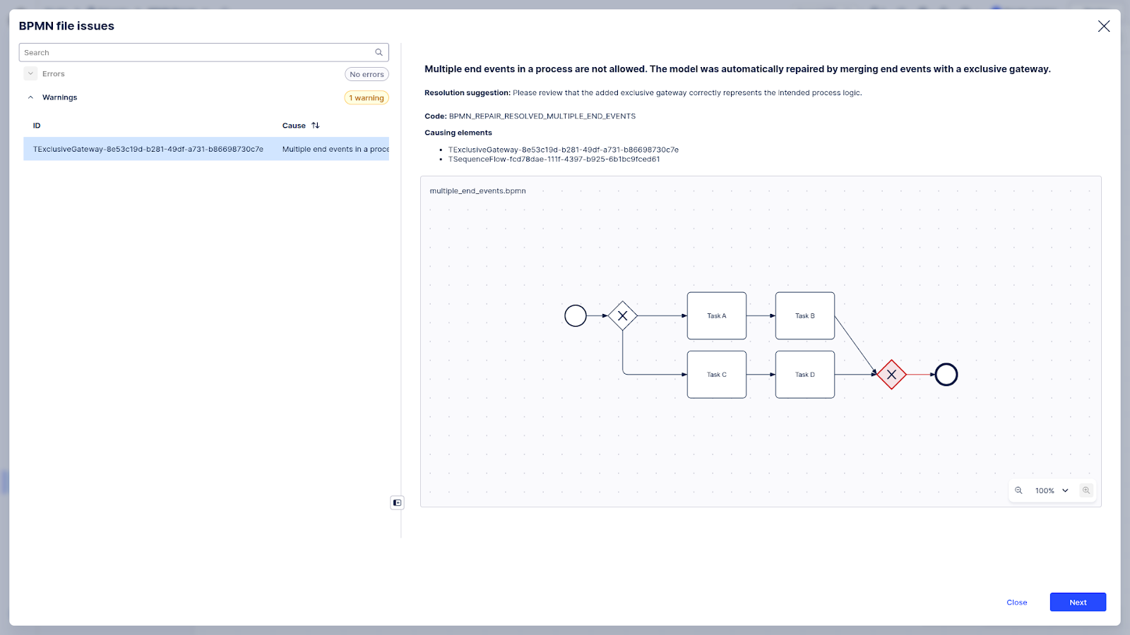

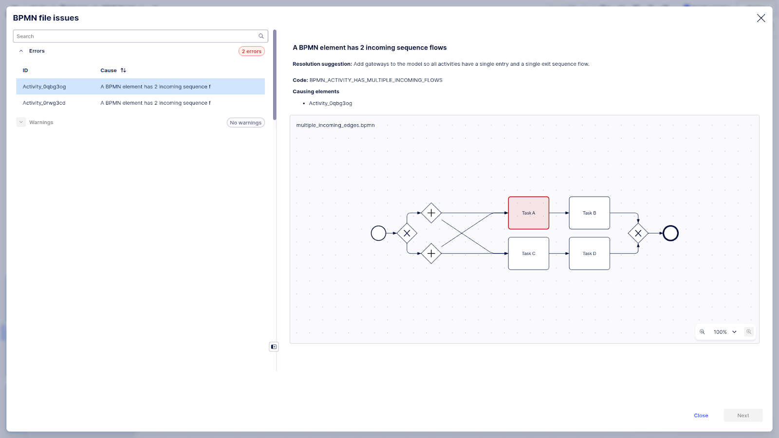

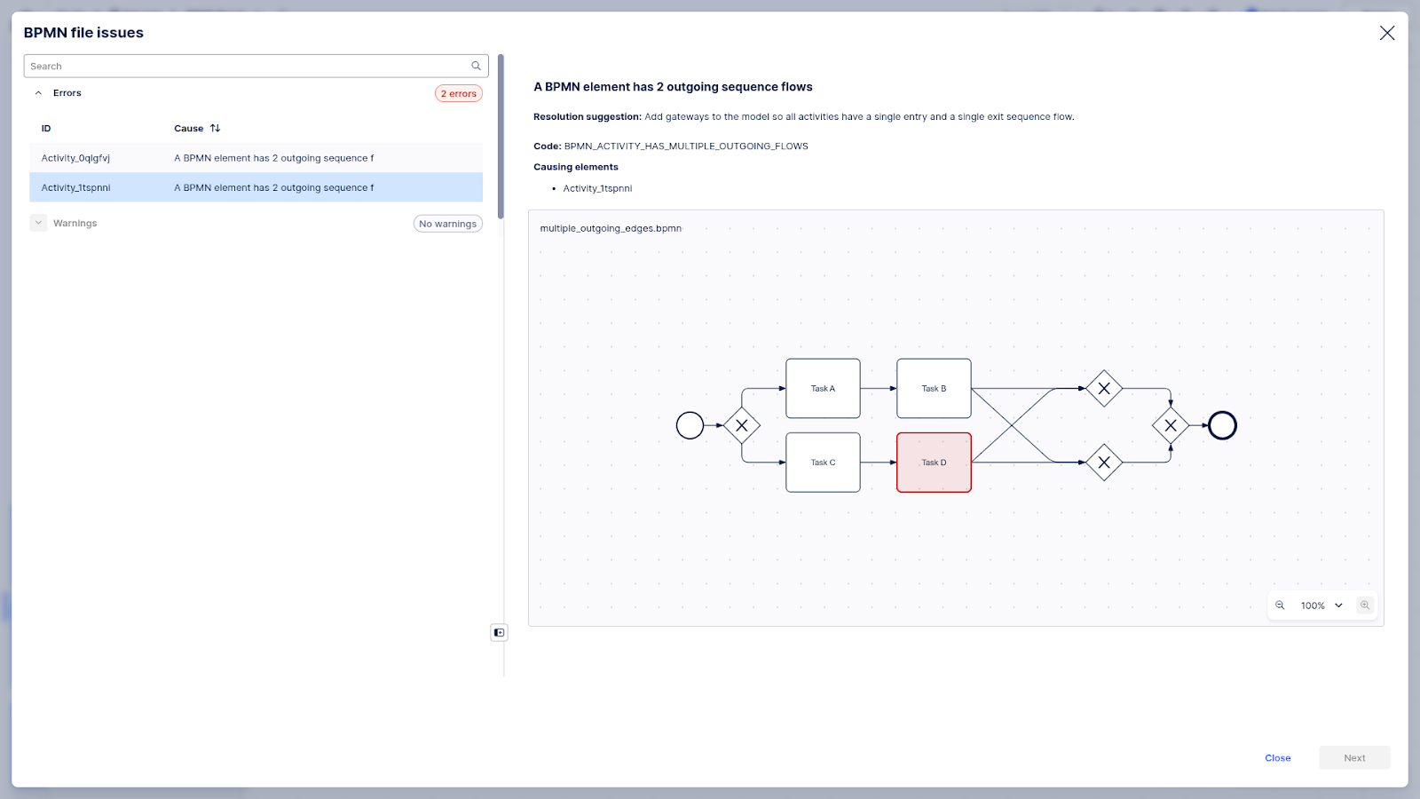

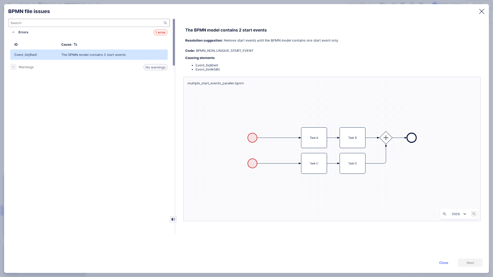

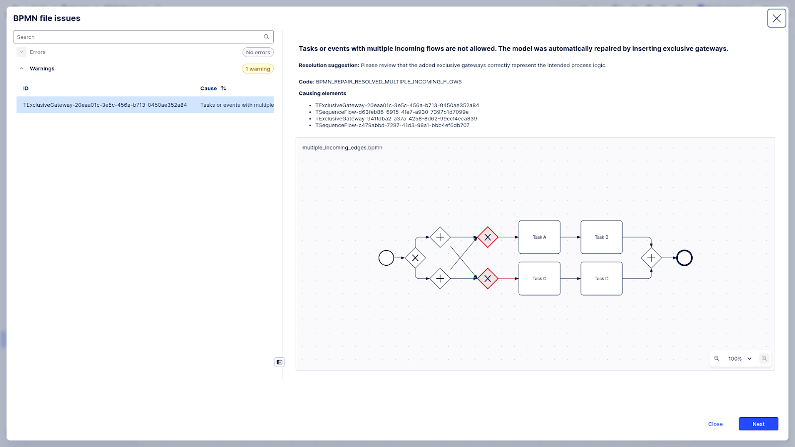

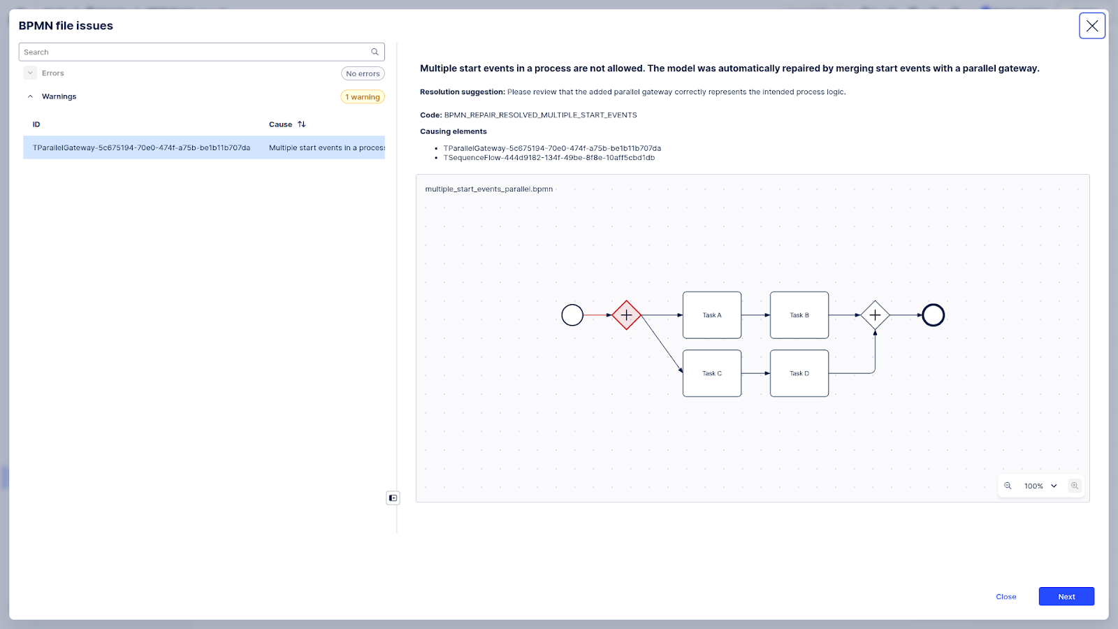

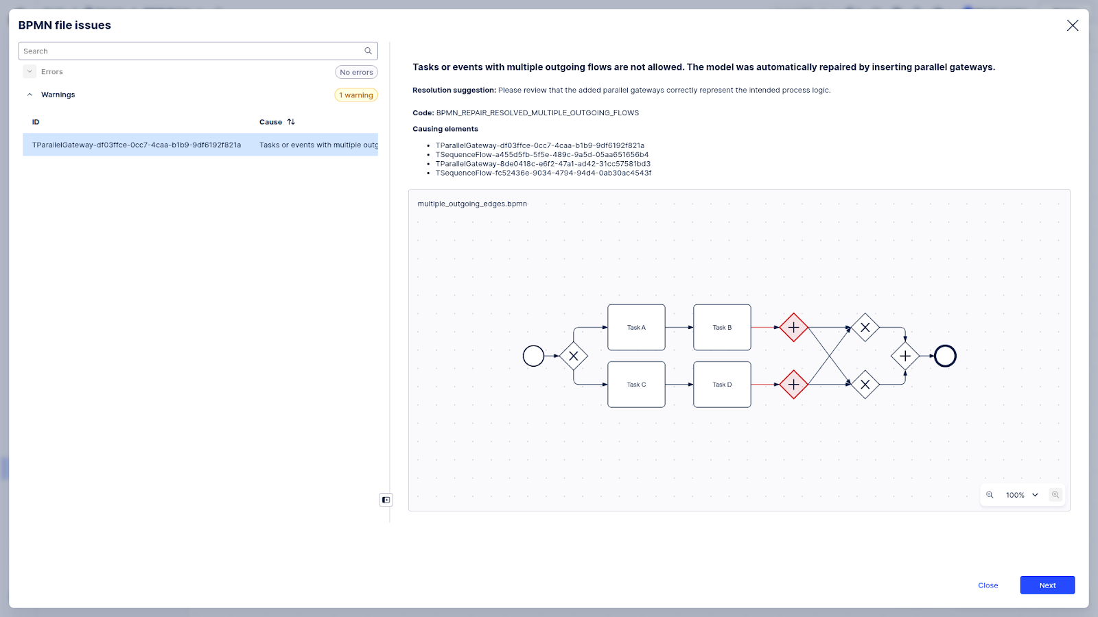

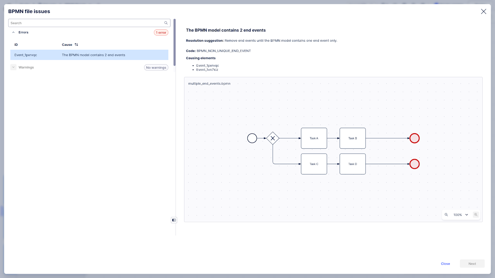

Target model complexity in Process Adherence Manager
The complexity of your target model may affect its performance, with large numbers of parallel flows having a significant impact. Simplifying your target model where possible is good practice and will help improve performance.
