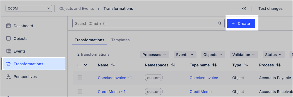

To create custom transformations for either objects or events using the Objects and Events dashboard:
  1. Click Transformations.
  2. Click Create and select either objects or events.
  3. Select create new or start from a template.
  4. Select the object to create the transformation for and then click Next.

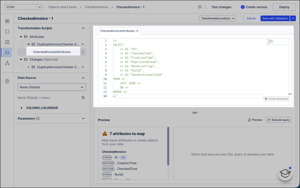

  5. In the SQL editor, select the transformation you want to edit.
    • Celonis transformations can’t be renamed.
    • Custom transformations are given an autogenerated name.

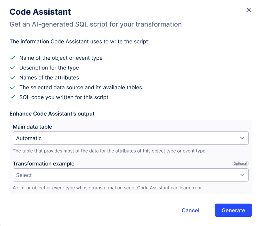

    Code Assistant for SAP and Oracle data connections
    For SAP ECC, S/4 or Oracle EBS/Fusion sources, click Code Assistant to quickly generate an initial transformation script with the AI-powered Transformation Assistant. It uses object, attribute, and source system context to create a custom script you can refine. All transformation types are supported except relationship transformations, and it works with both custom objects/events and Celonis catalog extensions.

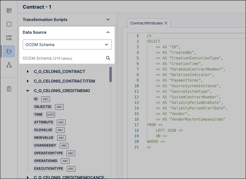

  6. Data source: Select the main data source for the business data in the Data source section. Queries run on this data source unless a data connection parameter is used.

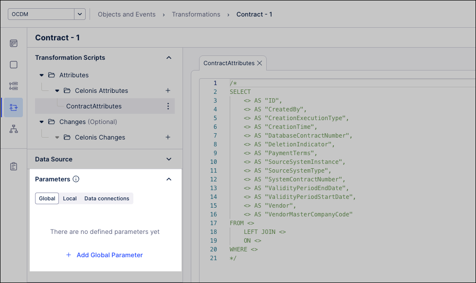

  7. Parameters: If applicable, set values for any local parameters used in the transformation:
    • Global parameters: belong to the workspace. You supply their values in the transformation editor.
    • Local parameters: belong to your script. You supply their values in the transformation editor.
    • Data connections: are specific data connections in the data pool. They override the default data source for the transformation.
  8. Script: If applicable, add a custom script or overwrite script (partial or full).
    • Only one overwrite per script type is allowed.
    • Extension scripts must populate all custom attributes or relationships for an object.
    • Each script opens with a generated SQL template. Remove comments and build a SELECT statement that maps source columns to target attributes.
    • Ensure object and event IDs are unique.

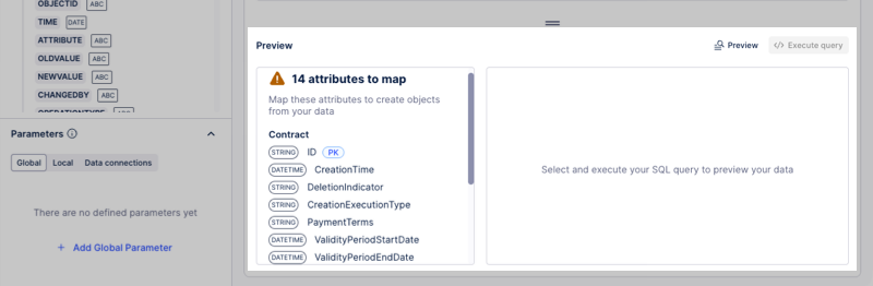

  9. Validate script: Use the Preview pane to see required attributes and key types.
    • Insert source columns using the Data Source explorer.
    • Use NULL for unmapped attributes and double quotes for source column names if needed.

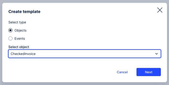

To create a transformation template using the Objects and Events dashboard::
  2. Select Templates.
  3. Click Create Template.
  4. Select the object or event to create the transformation template for and then click Next.
  5. In the SQL editor, select the transformation you want to create the template from.
