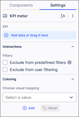

When configuring a KPI meter component, you have the following options:
  • KPI: Opens the PQL editor, allowing you to write a PQL statement using business metrics from your Knowledge Model. In addition, you can use the PQL editor to set the KPI display name, format, and unit of measurement.
    You can also select a KPI from the Metrics list in the PQL editor.
  • Interactions: Lets you select whether the KPI meter component is excluded from predefined and user-applied filters.
  • Coloring: Sets the colors used in the KPI meter bullet graph, based on predefined options.
Image showing the settings options for the KPI meter component.

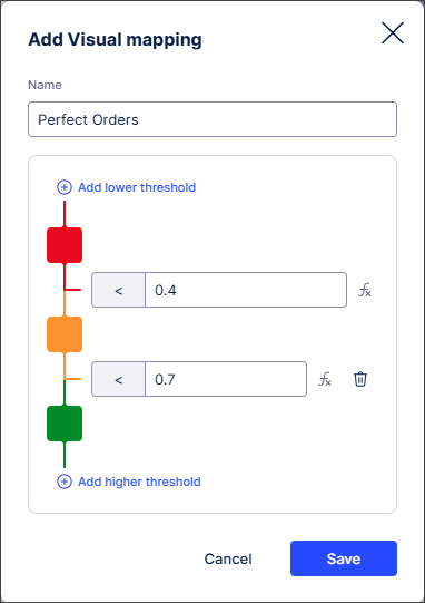

Adding a visual mapping
You can customize the colors and thresholds used in your KPI meter bullet graph by adding a visual mapping. You have the following options:
  • Name: Add a name for your color mapping.
  • Add lower threshold: Define the value of your KPI lower threshold.
  • Add higher threshold: Define the value of your KPI higher threshold.
You can add multiple threshold values if required.

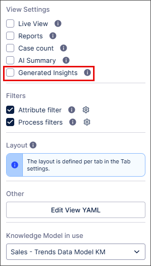

  1. In a View, enter edit mode.
  2. In View Settings, select Generated Insights.
    View setting panel showing the Generated Insights checkbox.

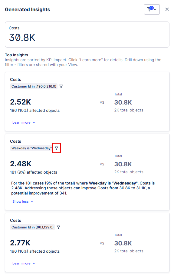

  3. In interactive mode, select the Generate Insights generate_insights_icon.png icon in a KPI list or KPI card component.
    A list of generated insights appears for that KPI component.
    Screenshot showing a list of the generated inights, with the filter icon highlighted
  4. Select the filter icon for an Insight you want to explore.

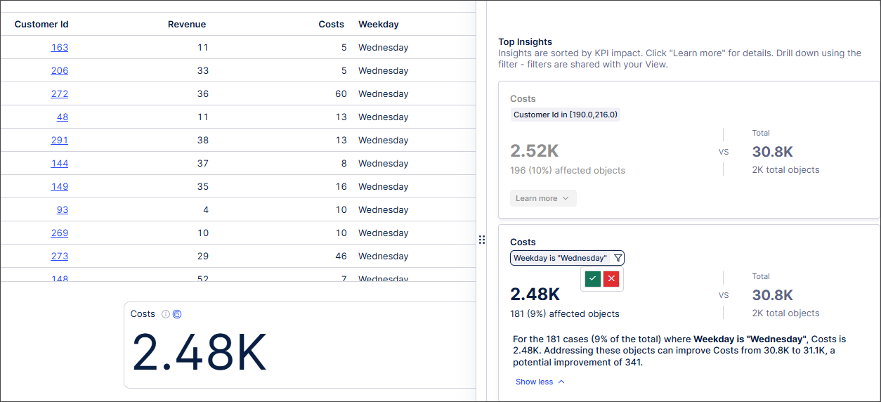

    A preview of the View with the Insight filter applied appears.
    Screenshot showing a preview of the KPIs with a generated insight filter applied
  5. Select Apply filter confirm_yes_green_tick.png to add the filter to your View.
    The View displays with the filter applied.
    New Insights are generated for your View based on the applied Insight filter. Selecting additional Insights and applying additional filters will help you drill down further into your KPI data.
