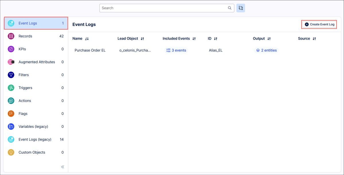

Creating case-centric event logs in the Knowledge Model
To create case-centric event logs in your KM:
  1. Click Studio and then open the package containing the KM you want to create the event log in.
  2. Open the KM asset.
  3. Click Event Logs and select Create Event Log.
  4. Configure your event log using the following settings:
    • Display Name: A human-readable label used in the user interface.
    • Short Display Name: Shorter human readable label for the object shown automatically on the Views whenever the Display Name is truncated. Can contain max 20 characters.
    • ID: A unique technical identifier used to reference this event log. Must be unique within all attributes in the KM.
    • Description: A human-readable description for the event log.
    • Internal Note: A field only visible within the KM.
    • PQL formula: Write the PQL reference for the activity table you want to show in your event log.
    • Record: Select the record you want to associate with a profile View.
    • Transition to other event log: See the possible transition between your current event log and another event log in your KM by adding an event log from the dropdown.
    A screenshot showing the event log configuration screen.
  5. Use the preview to check if your event log is working as desired. If not, re-configure your event log and try again.
  6. Click Save.
    The event log is added to your KM and can be used in the process explorer.
