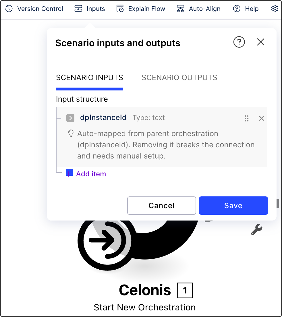

Define inputs for the Action Flow:
From the top bar, select inputs.
Add a new input called dpInstanceId of type Text.
The Digital Process Instance ID (dpInstanceId) serves as a link connecting a process instance to its corresponding Action Flow. It enables the Get Process Context module to retrieve specific data and ensures the Completion Event updates the correct instance.
