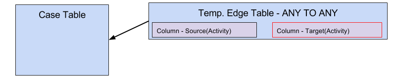

In this example several calls to the SOURCE and TARGET operators are done. After each call the status of the edge tables is shown.
  •    SOURCE ( Activity, ANY_OCCURRENCE[] TO ANY_OCCURRENCE[] )
    SOURCE is called with the ANY_OCCURRENCE[] TO ANY_OCCURRENCE[] edge configuration. A temporary edge table is created and the SOURCE column is added to it:
  •    TARGET ( Activity, ANY_OCCURRENCE[] TO ANY_OCCURRENCE[] )
    TARGET is also called with the ANY_OCCURRENCE[] TO ANY_OCCURRENCE[] edge configuration. As this is the same configuration as in the previous SOURCE call, the TARGET column is added to the existing edge table:

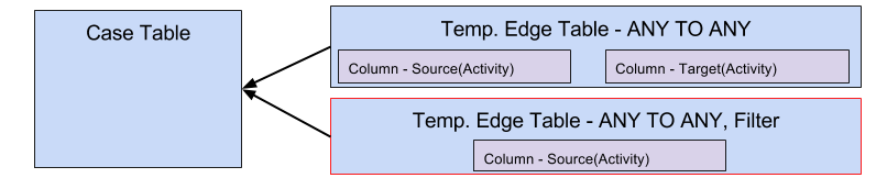

  • This column is added to a new temporary table, because the configuration is different to the previous ones:
       SOURCE ( Activity, Filter, ANY_OCCURRENCE[] TO ANY_OCCURRENCE[] )
    SOURCE is called with a filter column configuration. The Filter could be a call to REMAP_VALUES as shown above. Although the edge configuration ANY_OCCURRENCE[] TO ANY_OCCURRENCE[] is the same as in the calls before, the overall configuration differs because of the additional filter column. Therefore, a new temporary edge table is created, and the SOURCE column is added to it:
Multiple temporary edge tables can lead to problems if used within the same query. This happens if SOURCE and TARGET operators with different edge and filter configurations are used within the same query. The edge tables cannot be joined together by default because they do not have a common table. This behavior is described in Join functionality in more detail.
The only way of having multiple different configurations inside the same query is to aggregate values of the temporary edge tables to the case table using PU-functions, as shown in the following example:
