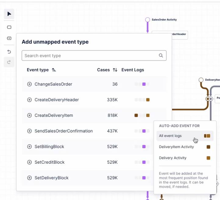

To add an event log, follow these steps:
  1. Open your target model.
  2. Select Edit to open your target model in Edit mode.
  3. Select Target Model and then choose Edit. The target model opens in the Target Model Editor.
  4. Select Add unmapped event type. Hover over the event you want to add, and select Auto-Add Event For and choose the event type you want to add.
  5. Select Update target model to save.

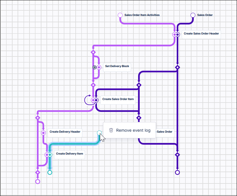

To remove an event log, follow these steps:
  4. Select the start of the event log you want to remove.
  5. Select Remove event log.
  6. Select Update Target Model.
    The event log and all associated deviations, variants and filters are removed from your target model.
