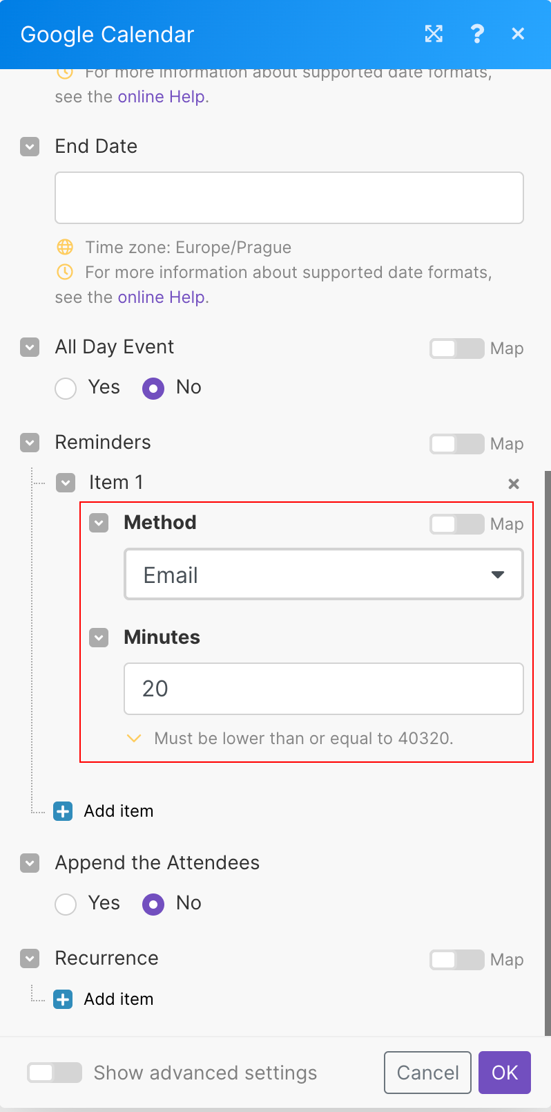

  1. Use the Google Calendar > Update an event module to add an email reminder to your event:

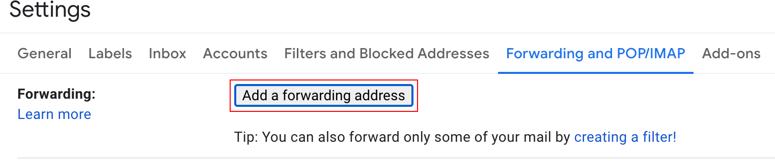

    1. Open your Gmail settings.
    2. Open the Forwarding and POP/IMAP tab.
    3. Click Add a forwarding address.
    4. Paste the copied mailhook's email address, press "Next", confirm by pressing "Proceed" in the popup window and close the dialog by pressing "OK".

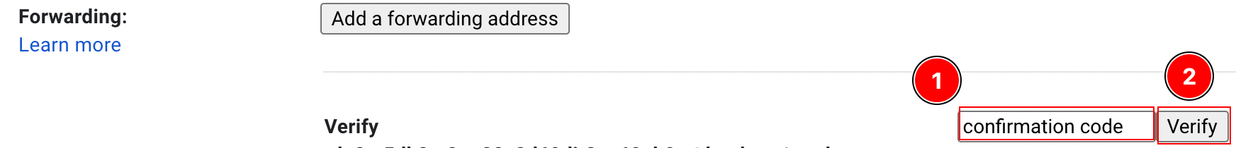

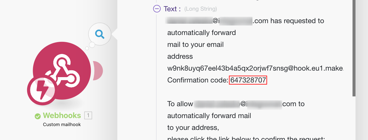

    7. Expand the Text item and search for the Confirmation code:
    8. Copy the Confirmation code.
    9. In Gmail, paste the Confirmation code in the edit box and click Verify:

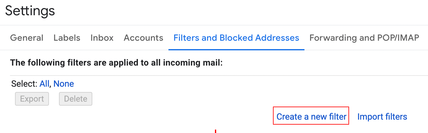

    10. Open the Filters and Blocked Addresses tab.
    11. Click Create a new filter:

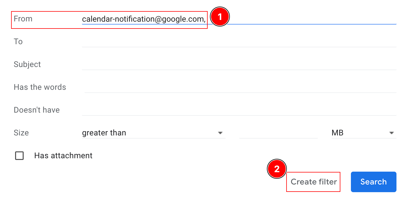

    12. Set up a filter for all emails coming from calendar-notification@google.com and click Create filter:

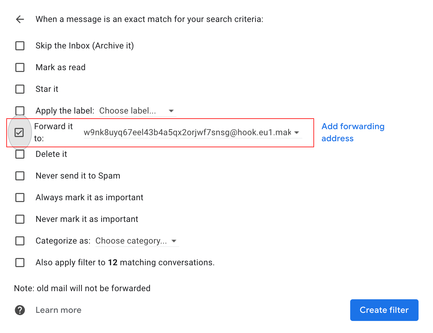

    13. Tick the "Forward it to:" checkbox and choose the mailhook's email address from the list:
    14. Click Create filter.

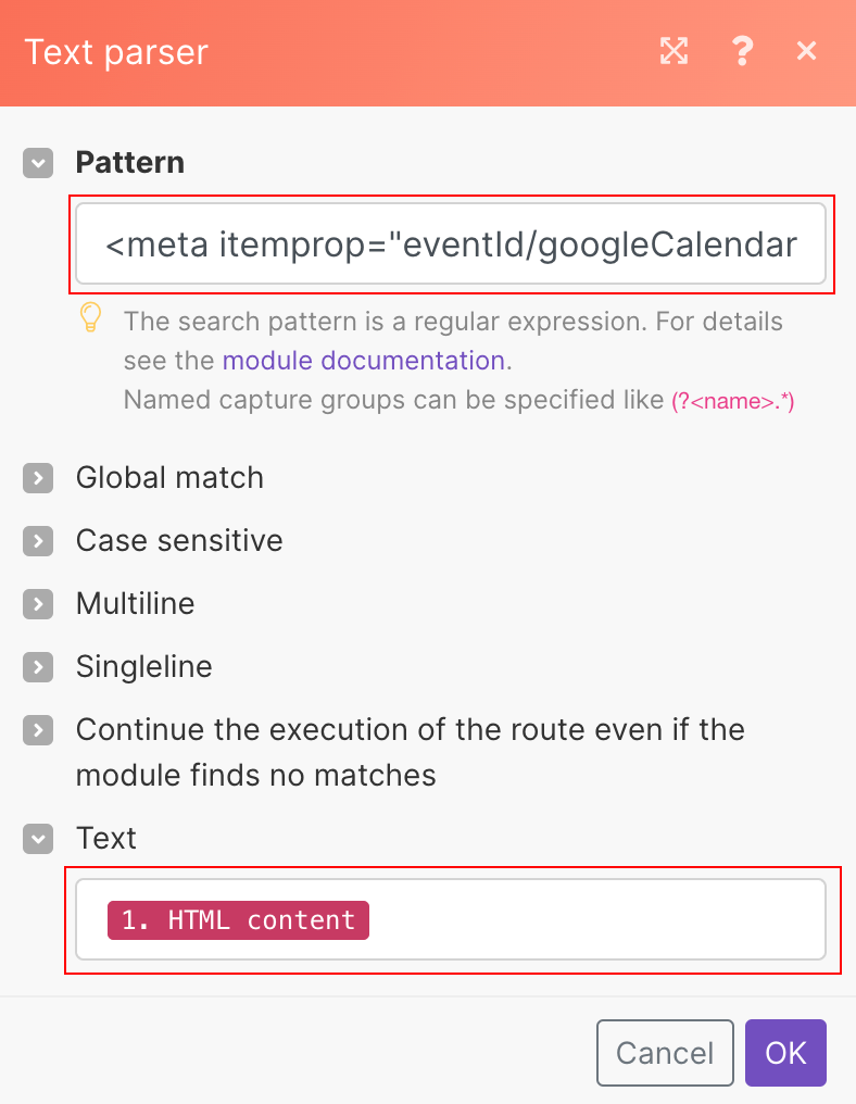

  4. In Celonis platform, you can add the Text parser > Match pattern module after the Webhooks > Custom mailhook module to parse the email's HTML code and obtain any information you need. For example, you can configure a module like this to obtain the event's ID:
    Pattern: <meta itemprop="eventId/googleCalendar" content="(?<evenitID>.*?)"/>
    Text: The HTML content item output from the Webhooks > Custom mailhook module:
