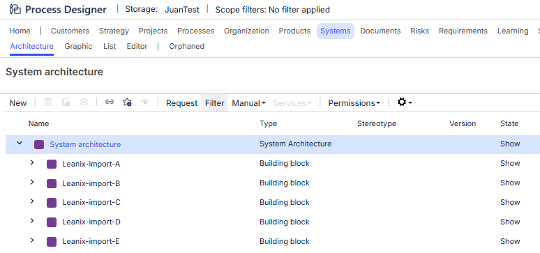

This action flow will create Building Blocks in Process Designer. It will avoid creating duplicates, so there is no danger in running this flow several times. The final result in Process Designer will look similar to this (with names going from A to Z):

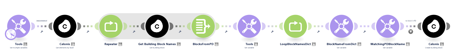

Function
This action flow will take the existing Building Blocks in Process Designer, take applications from LeanIX, put the LeanIX Applications data into structured JSON blocks that are associated with the corresponding Building Blocks, and then send these JSON blocks to a webhook.
A data structure must be set to the module red circled (see configuration below). Ideally this action flow should be configured to run manually the first time, but with the the “FirstRun” configuration variable set to “true”. After that, the variable should be set to “false” and the action flow can be set to run as scheduled.
If the Building Block assigned to the Application cannot be found, it will try to get a request to a non existing url (http://ProcessDesignerBlockNotFound/{blockName}) that will cause an error, so the user is notified and can take corresponding actions.

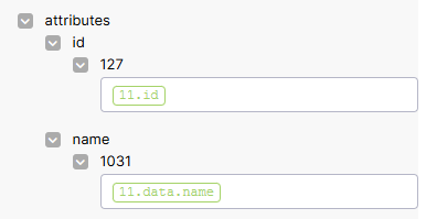

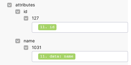

The data structure needed to configure the JSON module (circled in red) can be generated as follows:
  1. Select Create data structure and give it a name.
  2. Select Generate. Copy the data from Appendix A to the Sample Data field. You will see some field references with a transparent background.
  3. Click Save and execute the action flow.
  4. Open the JSON module again. You will see the same field references, but this time with a solid background.
  5. Close the popup and save the action flow.

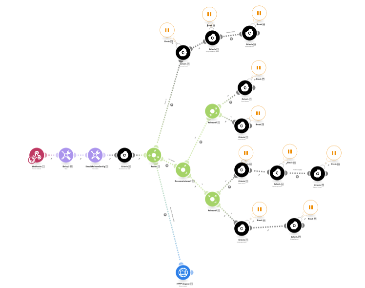

Function
This action flow will:
  • Take the LeanIX Application (LA) data from a webhook
  • Depending on the state of LA and the matching Process Designer Applications (PDA):
    • If LA  does not match a PDA and it is not decommissioned: Create and release a PDA
    • If LA matches more than one PDA: PDA is in an unstable state. It means there is at least one PDA in “in process” state and at least one in “released” state.  It will make a POST to an inexistent url (https://sendErrorUrl) which will cause an error. In this request the content  has information of which PDA/version is in this state (*).
    • If LA matches just one PDA:
      • If LA is decommissioned:
        • If PDA  is in “release” state: It will expire the PDA
        • If PDA is in “in process” state: It will delete the PDA
      • If LA is not decommissioned:
        • If PDA is in “release” state: It will create a new version  (PDA1), update and release PDA1 (and this will expire PDA).
        • If PDA is in “in process” state: It will update and release the PDA
Each module that interacts with Process Designer has an error handler attached. It will retry an operation up to 3 times. If the operation still doesn't work, it will fail after the 3rd try.

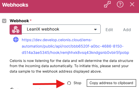

  1. Configure the webhook:
    1. You should be configuring the webhook in a duplicated browser tab as outlined in step 2.
    2. Select Webhook, click the Create a webhook button, give it a meaningful name, and it will start “listening”:
    3. Click the Copy address to clipboard button. Go back to the tab where you have step 2 open, and finish the step. Then you can come back here and continue configuring the webhook.
