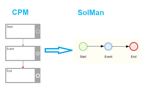

Events
All events from Celonis Process Management will be synchronized to adequate SAP Solution Manager event:
StartEvent => StartEvent
IntermediateEvent => IntermediateEvent
EndEvent => EndEvent

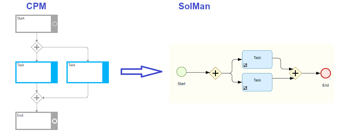

Celonis Process Management Gateway AND will be synchronized as an SAP Solution Managers Gateway Parallel:

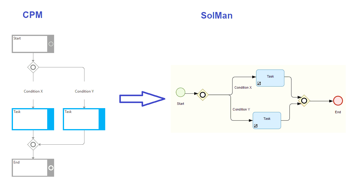

Celonis Process Management Gateway OR will be synchronized as an SAP Solution Managers Gateway Inclusive. Since SAP Solution Manager does not have “Condition” elements, conditions will be written on the connector arrows:

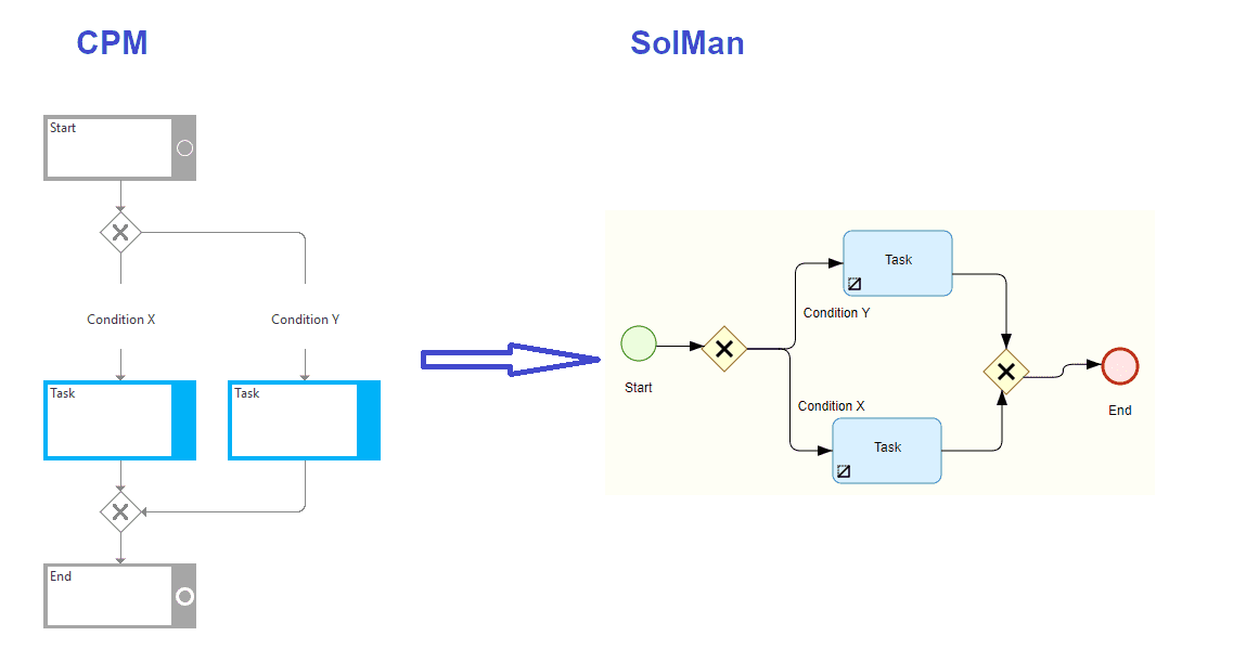

Celonis Process Management Gateway Either-OR will be synchronized as a SAP Solution Managers Gateway Exclusive. Since SAP Solution Manager does not have “Condition” elements, conditions will be written on the connector arrows:
