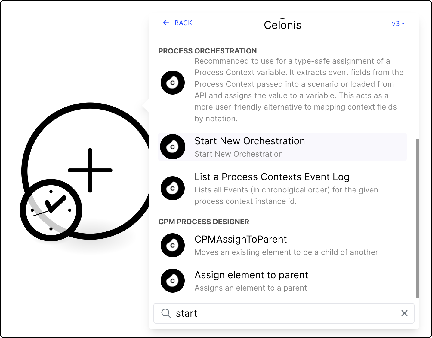

  3. In the Action Flow editor, click Add module and from the list select Start New Orchestration.
    List of Action Flow modules with the Start New Orchestration module selected.
