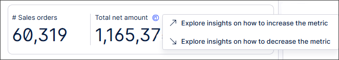

Generated Insights show how you can increase or decrease individual KPI values in KPI cards and KPI lists. You can also see the impact of different attributes on the generated Insight data, before applying the attributes selected as filters to the overall View.

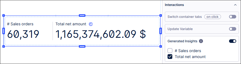

  1. In edit mode, select a KPI component in your View.
  2. Select Settings > Interactions.
  3. Enable Generated Insights.
    If the component is a KPI list, you can also select individual KPI list items.
    KPI list component displaying two KPIs, one KPI having generated insights enabled.
    The Generate Insights Image of the Generated Insights icon. icon displays when Generated Insights is enabled for a KPI.
  4. In interactive mode, select Generate Insights Image of the Generated Insights icon..
    In this example. you can also select the metric behavior you want to explore. However, if the desired behavior is already defined in the Knowledge Model for this metric, the metric behavior option won't display.
    KPI list component displaying options to increase or decrease the KPI metric.

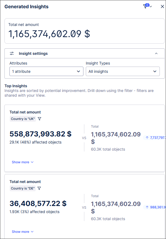

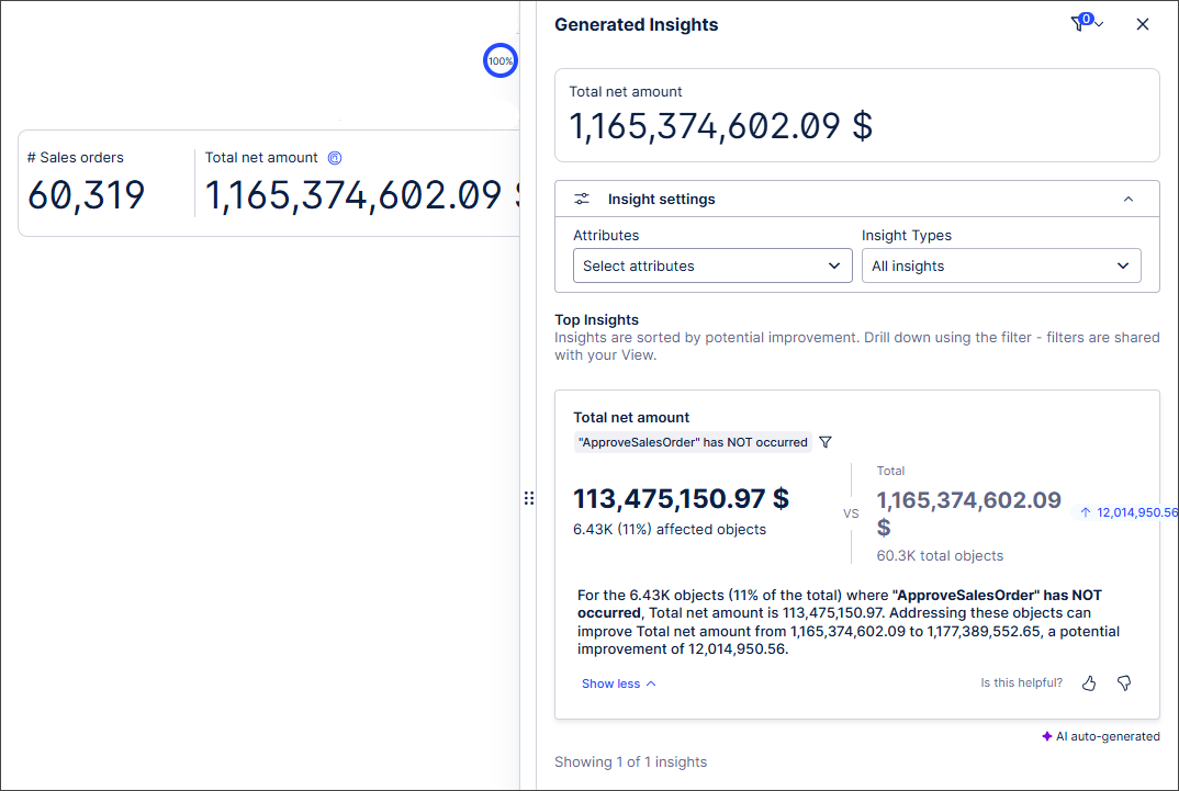

    Generated Insights information appears for the KPI component. In this example, we're exploring how to increase the total net amount.
    Screenshot showing Generated Insights.

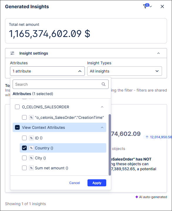

  5. Select attributes to narrow your focus, Here, we want to explore increases to the total net amount by country.
    Generated Insight information with specific attributes selected.
  6. The Generated Insight displays KPI data based on the selected attribute.
    Generated Insights filtered using the selected attributes.

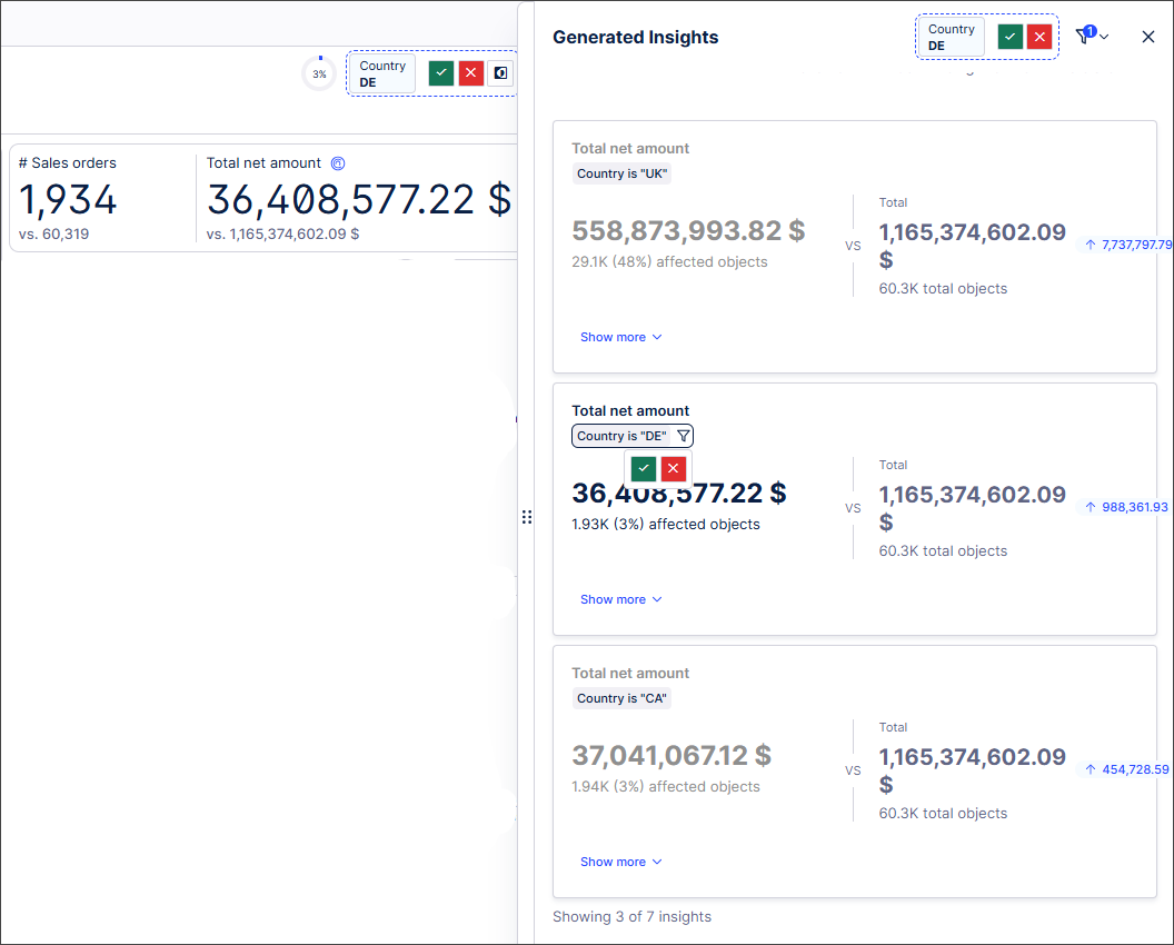

  7. Select the filter icon for an individual attribute value to preview the impact on the overall data.
    A preview of the View with the filter applied appears.
    Preview of the View with the attribute filter applied throughout.
  8. Select Apply filter Confirm icon to add the filter to your View.
    The View displays with the filter applied.
    A screenshot showing the generated Insight for a specific country applied as a filter to the overall data
