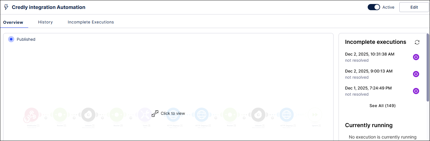

To open the incomplete executions tab, select the Action Flow in the list of Action Flows and switch from the Overview tab to the Incomplete executions tab.
The incomplete executions overview section in Action Flow.

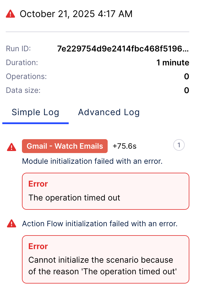

You might want to check the Action Flow execution log first to investigate why the error happened:
  1. Go to the History tab.
  2. Locate the failed execution log and click Details.
  3. Click the module that has a warning status.
    Details of an Action Flow incomplete executions.
