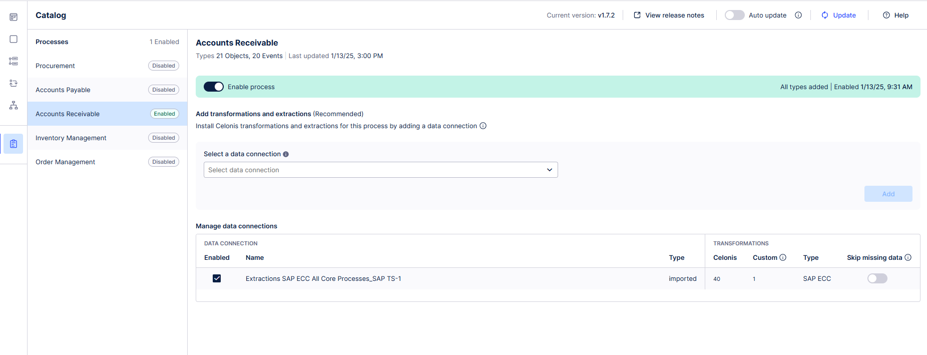

  • Enable and configure the Accounts Receivable process for SAP from the Celonis catalog.

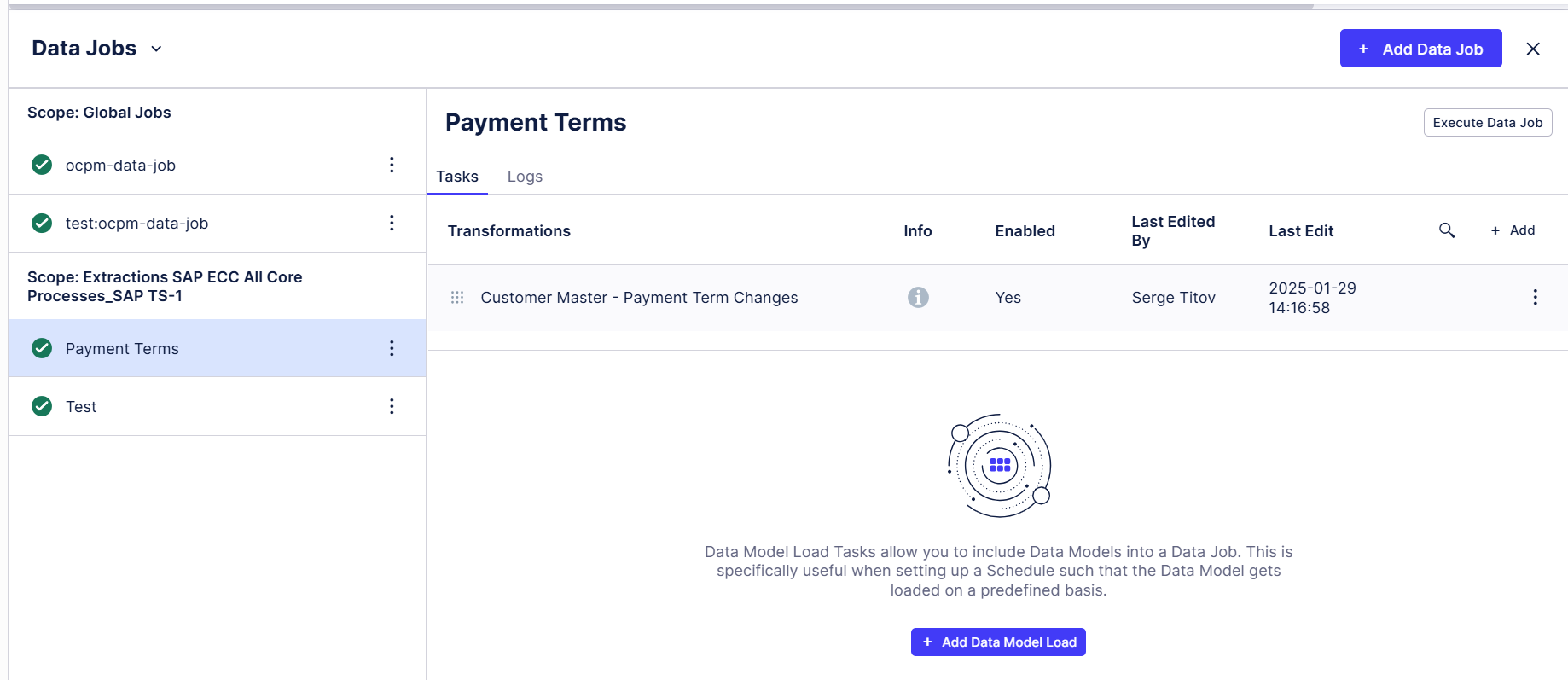

  1. From the Celonis navigation bar, select Data > Data Integration, then select the data pool where you’re working with objects and events. Select Data Jobs in the data pool.
  2. Select each data job in each scope, and add to each the transformation “Customer Master - Payment Term Changes”.

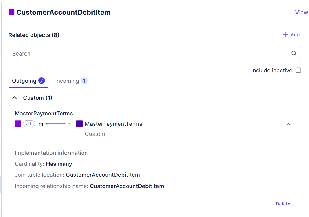

  6. Extend the Celonis object type CustomerAccountDebitItem to add custom attributes, and add the transformation script for it. Here’s how:
    • Browse or search to find the Celonis object type CustomerAccountDebitItem in the list of object types, and select it.
    • Select Object details.
    • Click Add to add each of these attributes:
      Object
      Type
      MasterDataPaymentTermCode
      String
      MasterPaymentTermsSource
      String
      PostingDate
      Datetime
      SalesOrganization
      String
      DistributionChannel
      String
      Division
      String
      MasterPaymentTermsValidity
      String
      MasterPaymentTermsValidUntil
      Datetime
    • Click Save to apply the extension to the CustomerAccountDebitItem object type.

    • Click Save to save and validate the transformation.
  7. Create an object to object relationship between the new custom object type MasterPaymentTerms and the Celonis object type CustomerAccountDebitItem. Here’s how:
    • In the pane for the Celonis object type CustomerAccountDebitItem, select Relationships to objects.
    • Click Add, and add an outgoing relationship to the custom object type MasterPaymentTerms. Make this a many to many (m:n) relationship. Use the suggested name for the relationship.
    • Click Save to create the object to object relationship.

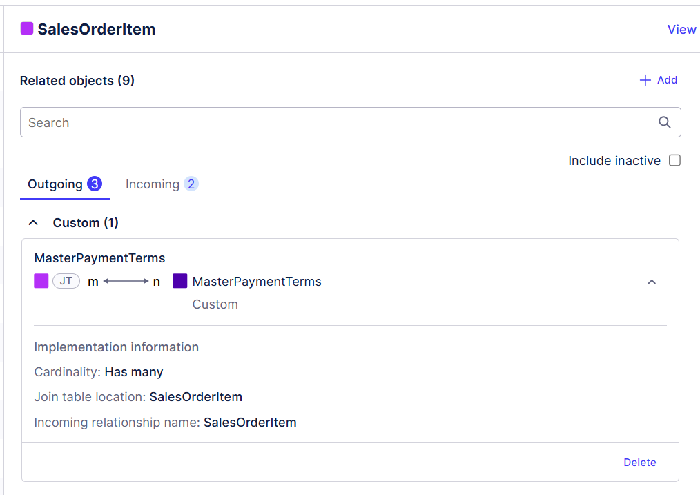

  10. Create an object to object relationship between the new custom object type MasterPaymentTerms and the Celonis object type SalesOrderItem. Here’s how:
    • In the pane for the Celonis object type SalesOrderItem, select Relationships to objects.

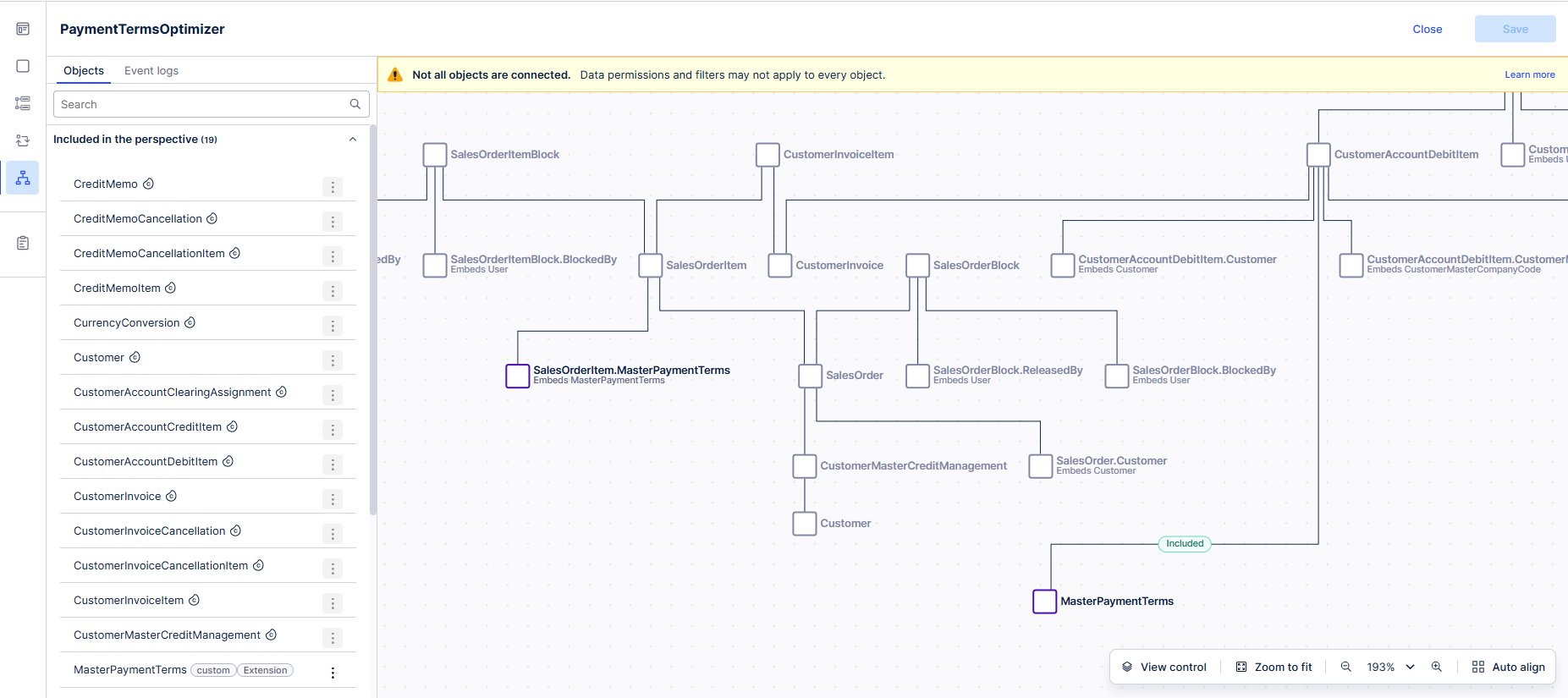

  14. Extend the Celonis catalog perspective for the Accounts Receivable process to add the MasterPaymentTerms object. You’ll add it twice, once as a linked object and once as an embedded object. The perspective already contains the other objects, so their new attributes will be added automatically. Here’s how to extend the perspective:
    • Go back to the Objects and Events environment, and select Perspectives in the top navigation bar. Find the Celonis-supplied Accounts Receivable perspective (perspective_celonis_AccountsReceivable).
    • Click the Extend button, or go to the context menu (the three vertical dots) for the perspective and select Extend.
    • Type a name for the extension - we recommend “PaymentTermsOptimizer” - and click Next.
    • Search in the Object list for the custom object type MasterPaymentTerms. Select it to see its details pane.
    • Select Linked objects in the sidebar.
    • Click Add and start typing the name of the CustomerAccountDebitItem object type, then click to select it.
    • Select the checkbox button for the MasterPaymentTerms relationship between the two object types.
    • Now search in the Object list for the Celonis object type SalesOrderItem. Select it to see its details pane.
    • Select Embedded objects in the sidebar.
    • Click Add and start typing the name of the MasterPaymentTerms object type, then click to select it.
    • Select the radio button for the MasterPaymentTerms relationship between the two object types.
    • Click Save to save the extension.
  15. Select Publish > Publish to development to publish all your changes to the development environment or development and production.
  16. Follow the instructions in Running transformations to run test:ocpm-data-job to create objects and events in the development environment or ocpm-data-job to create objects and events in the production environment. Check that there are no errors.
  17. In the data pool where you’re working with objects and events, carry out a full load of the data model for the extended perspective PaymentTermsOptimizer (or your chosen name for the custom perspective).
