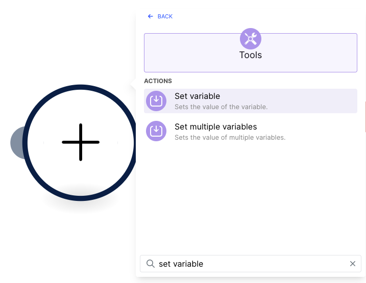

  4. At the beginning of your automation, add a new module called Set variable.
  5. Connect the new module to the rest of your automation.

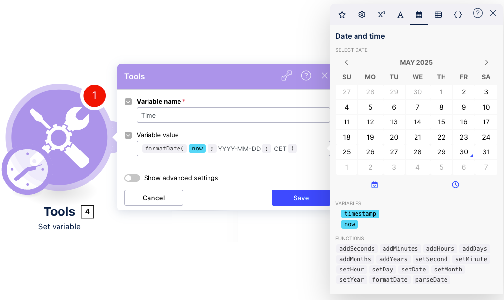

  6. In the module settings:
    1. Give your variable a name.
    2. As the variable value, set formatDate.
    3. Use the now variable in the format date and set your desired format date and time zone.

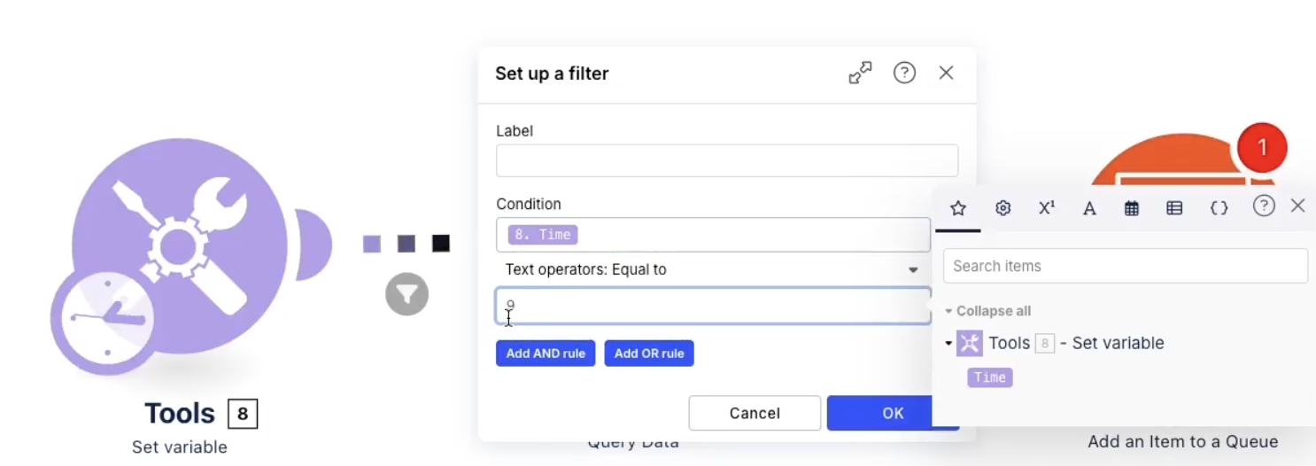

  7. Create a filter between the set variable module and the rest of the automation:
    1. Click the wrench icon on the connection line between the first two modules.
    2. Click Set up a filter.
    3. As condition, enter the variable you set in the Set variable module.
    4. In the text operator field, enter the time at which you wan to run your automation.
