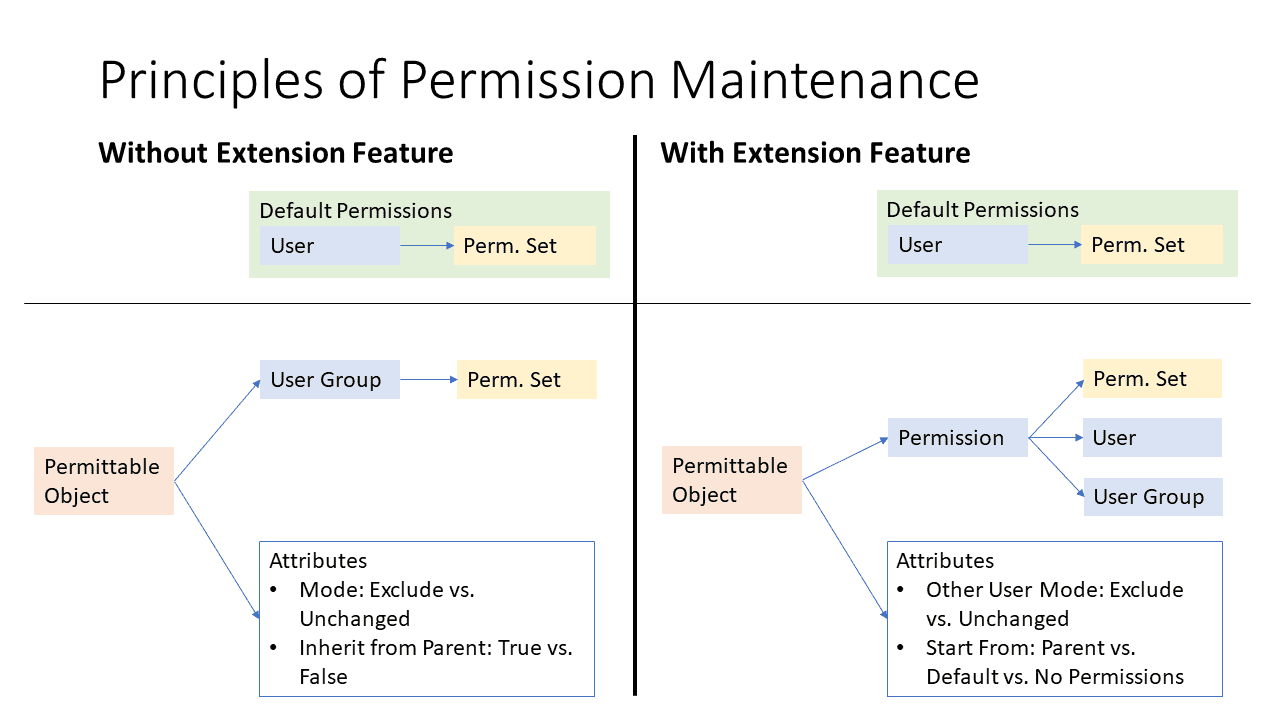

By activating this feature, the permissions assignment is made more flexible and comfortable, as permissions are set directly at the permittable process or object. We point out that this feature Is one way. Once it is activated, it cannot be deactivated again.
The following picture illustrates the comparison of the standard permission maintenance with the activated extension feature:

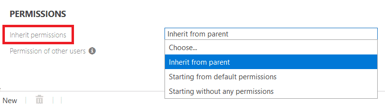

2. Define inheritance and effect on other users
There are three options to define on which basis the permissions are set up:
  • Inherit from parent: Permissions of the selected process or object are automatically adopted from the parent element. Further permissions on this element may be added if required.
    Example: A new created Sub Process should inherit the permissions of the higher-level Main Process. Additionally, the permissions of this Sub Process should be differentiated for a new project team (user group) or team member (user).
  • Starting from default permissions: Permissions are set on the basis of existing permission sets assigned to users or user groups before. If no permission sets have been applied, the Celonis Process Management standard application roles (e.g. Author, Architect) are used.
    Example: The existing permissions (permission sets or application roles) are adopted by default for a new created Sub Process. Additionally, the permissions of this Sub Process should be differentiated for a new project team (user group) or team member (user).
  • Starting without any permissions: Permissions are designed and granted from scratch. The Celonis Process Management standard application roles will not be considered.
    Example: Any existing permission sets and application roles are not used. The permissions of a new Sub Process are completely redefined; this should be done consistently for all processes and objects.

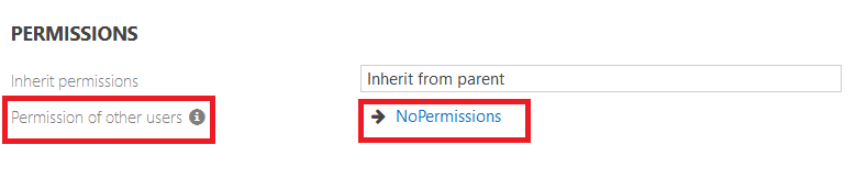

Regarding the effect on other users, there are two possibilities to set inside the attribute Permission of other users:

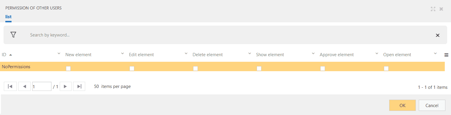

  • permission set without any permissions: In this case you may select a permission set without any permissions, see image below; therefore, if the selected process/object is starting without any permissions and you select a permission set without any permissions then other users have no access to the selected process/object.
    Example: A new branch in the process structure should only be available for a newly set up project team (user group). The remaining employees of the company should not have access, not even Viewer rights.
  • no permission sets at all: In this case you may select a permission set without any permissions, see image below; which means, if the process/object inherits from parent or starting from default permissions the granted permission of other users remains unaffected.
    Example: The permissions of a new branch in the process structure should be differentiated for specific users or user groups. The existing access rights (e.g. Viewer rights) of the remaining employees remain unchanged.
In other words, based on the Inherit permissions selection, the Permission of other users is: * either a limitation of other users permissions if Inherit from parent or Starting from default permissions is selected, * or an exact prescription of permissions if Starting without any permissions is selected.

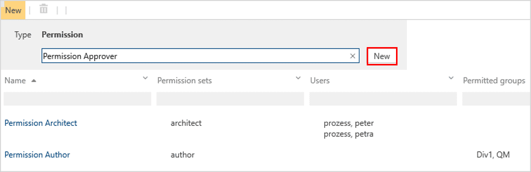

3. Create specific permission types

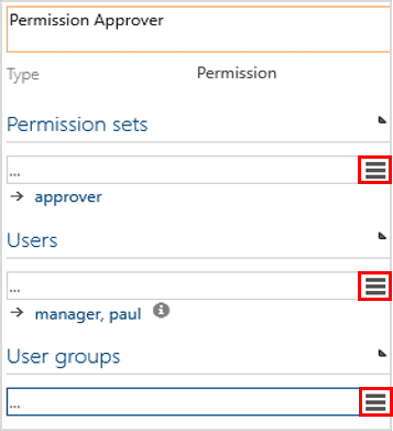

Click on New to create specific permission types, of course only usable for the selected element. It is recommended to create a specific permission type for each applicable permission set.
In the Detail Content, add corresponding Permission sets, Users and User groups to each permission type.
Finally, confirm with OK.
