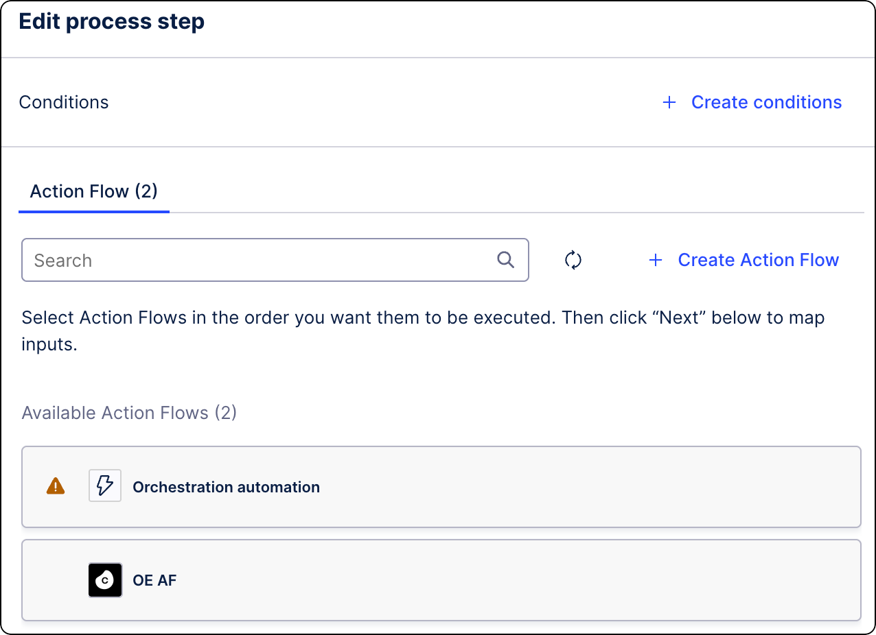

    The edit process step screen opens. Here’s where you can view all Action Flows compatible with your Process Orchestration. You can directly access the individual Action Flows to make changes, activate them, or check their status.
    The Edit process step popup windows with a list of Action Flows available for this step.
  4. Select from existing Action Flows, or create a new one:

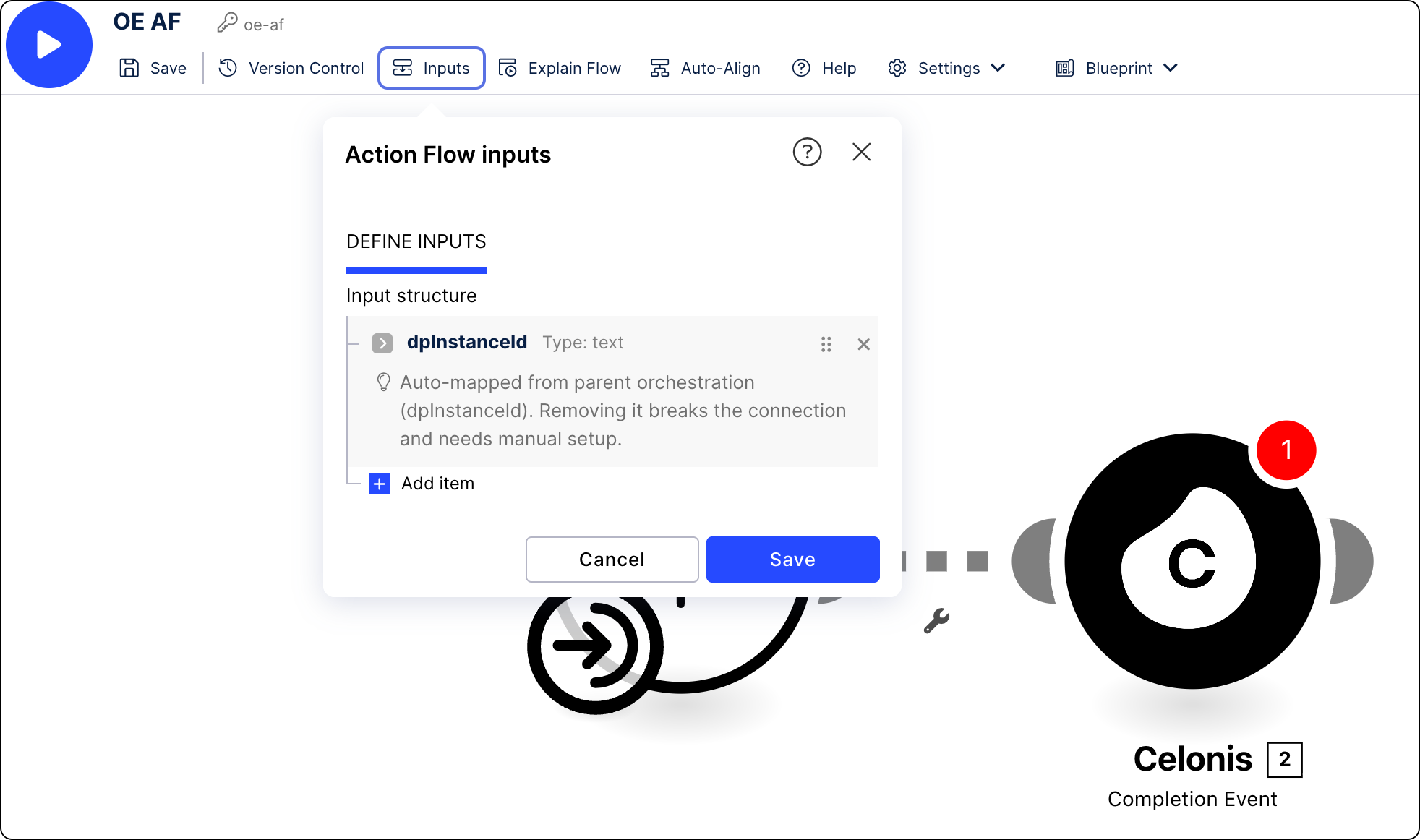

        Your Action Flow is created with the following predefined settings to make it immediately available for use in Process Orchestration:
        • set to on-demand
        • contains the dpInstanceId input
        • contains the Completion Event module
          The Action Flow editor with the Scenario inputs and outputs dialog open over the module canvas. The active Scenario Inputs tab displays a text parameter named dpInstanceId that is auto-mapped from a parent orchestration.
        • has a custom OAuth 2.0 client created that the Action Flow can use for connection

      5. Go back to your Process Orchestration and from the list of available Action Flows, select the one you've just created.
        If you can't see your Action Flow on the list, refresh the edit process step view.
