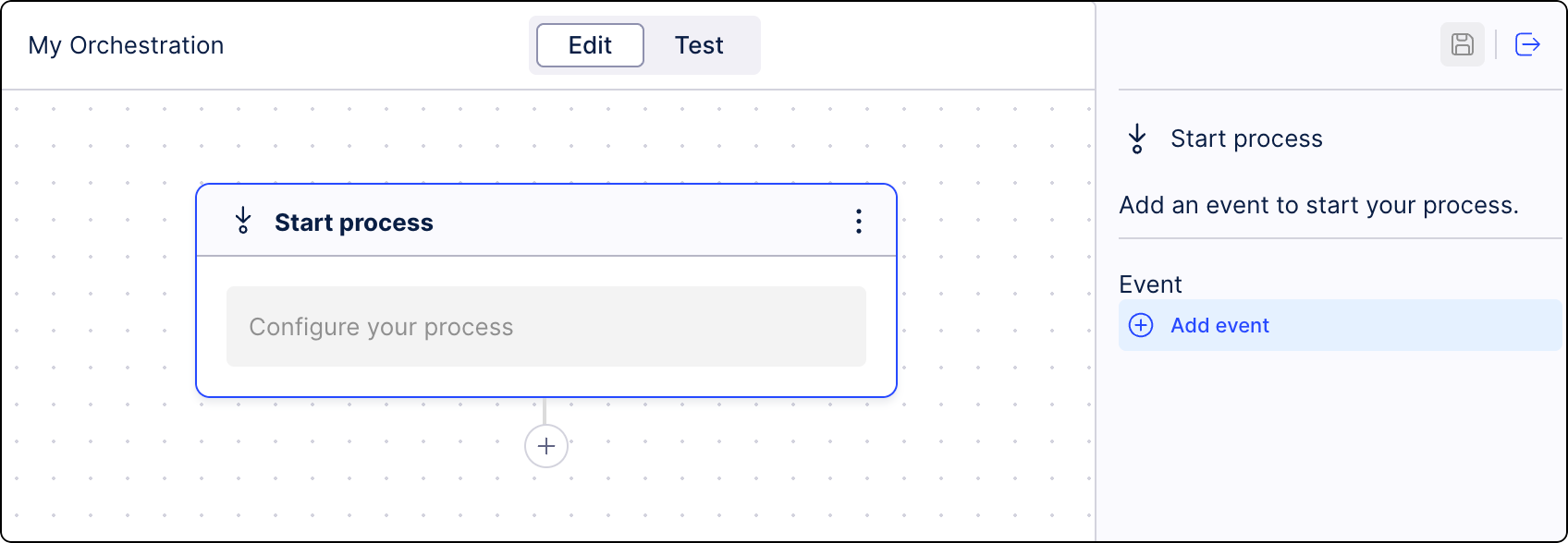

  1. In Studio, go to your package and select your Process Orchestration
  2. Select the Start process step and from the side panel, click Add event.
  3. In the Start Step editor, click Add event.
    Process Orchestration workflow with a Start process step added and the Add event option showed.
