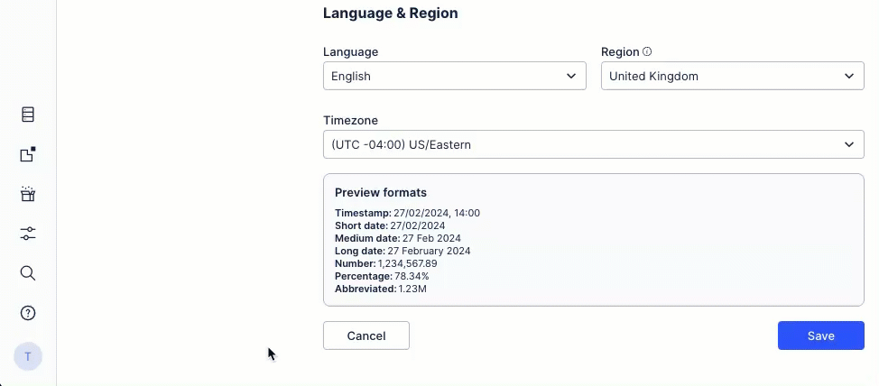

Localized formatting allows numbers and dates to update dynamically based on the user's region. This feature is supported in Views and Knowledge Models using specific YAML format strings or the Visual Editor dropdown.
You can update your location / region in your user profile by clicking your profile icon and then clicking Edit Profile:

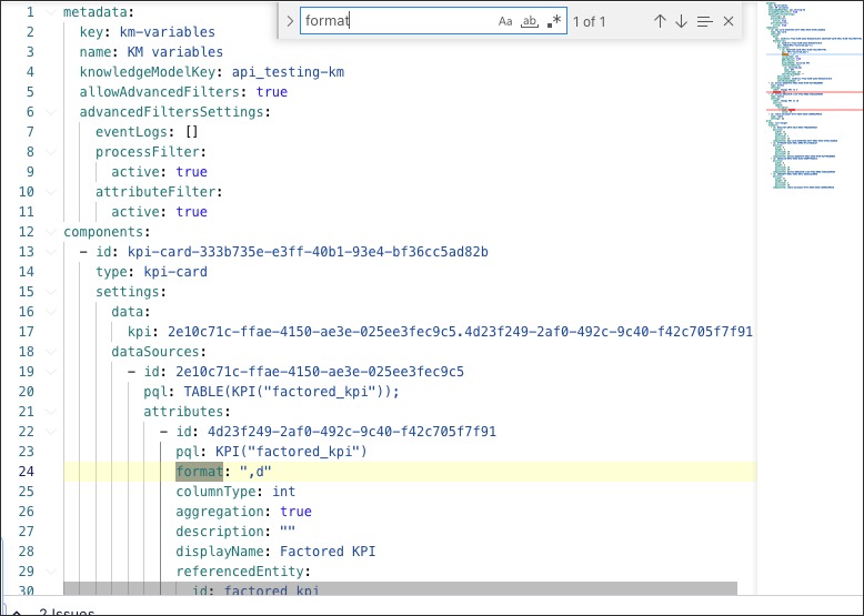

Update format with YAML
Normally this string replacement operation is easier to realize in YAML by searching (CTRL + F / CMD + F) for specific attributes and replacing the old values with the new ones. In this case, you can either look for the attributes “format” and “dateFormat” or with the values you want to replace, for example “%Y-%m-%d”:

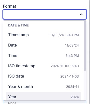

Update with visual dropdown
Additionally, a new formatting dropdown is available for the Visual Editors (Only in Views) to facilitate easy selection:
