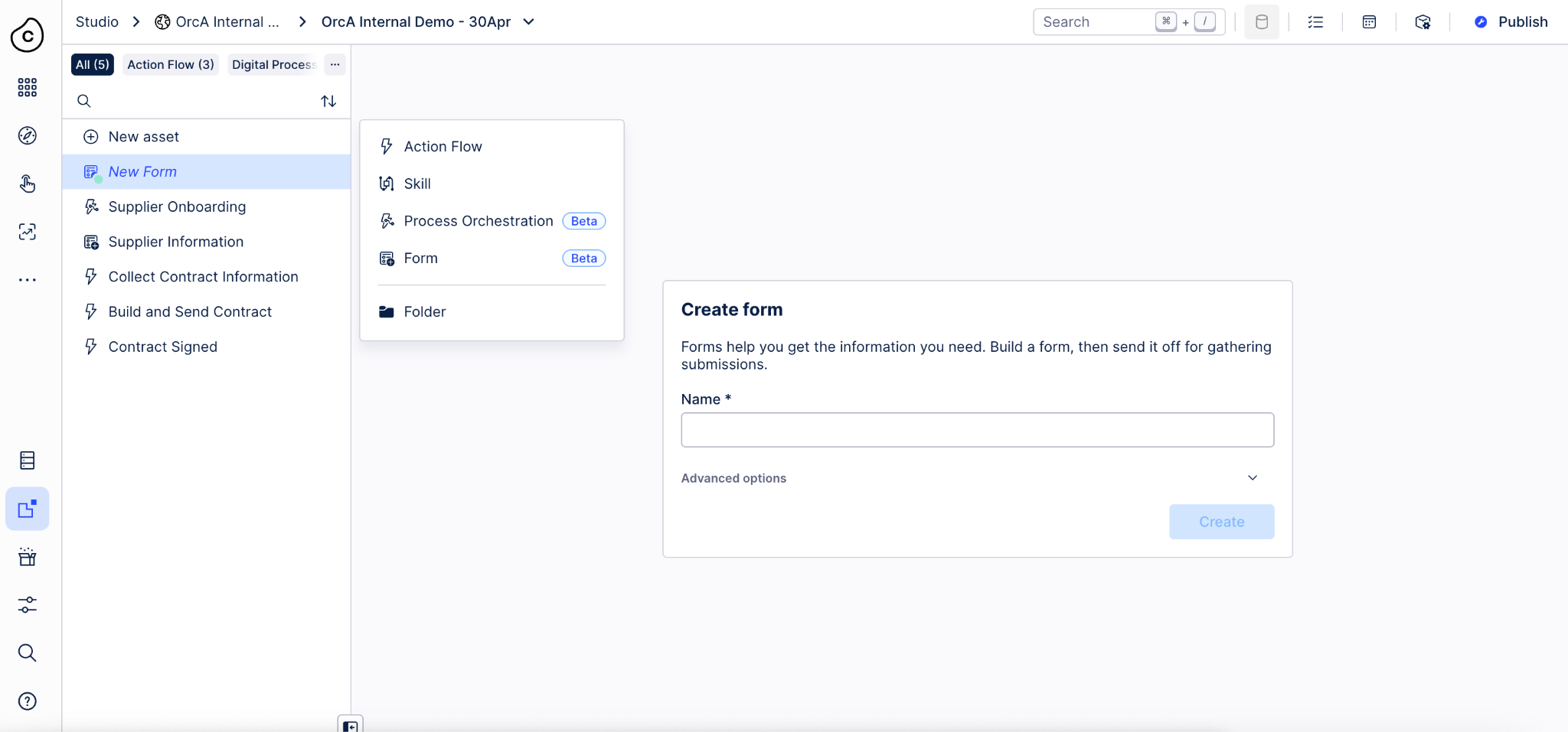

In Studio, go to your package.
Click Create Asset and select Form.
Give your form a name.

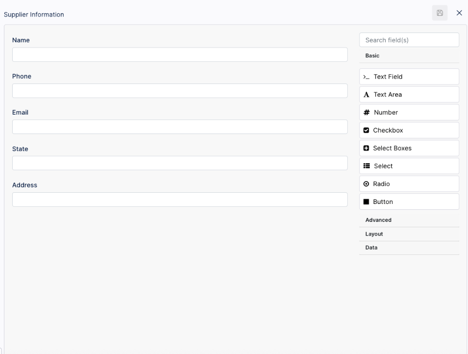

Choose the components that you want to have in the form. You can select from the basic, advanced, layout, and data components. Add the components by using the drag and drop feature, which allows for putting the components at any place, before or after other components.

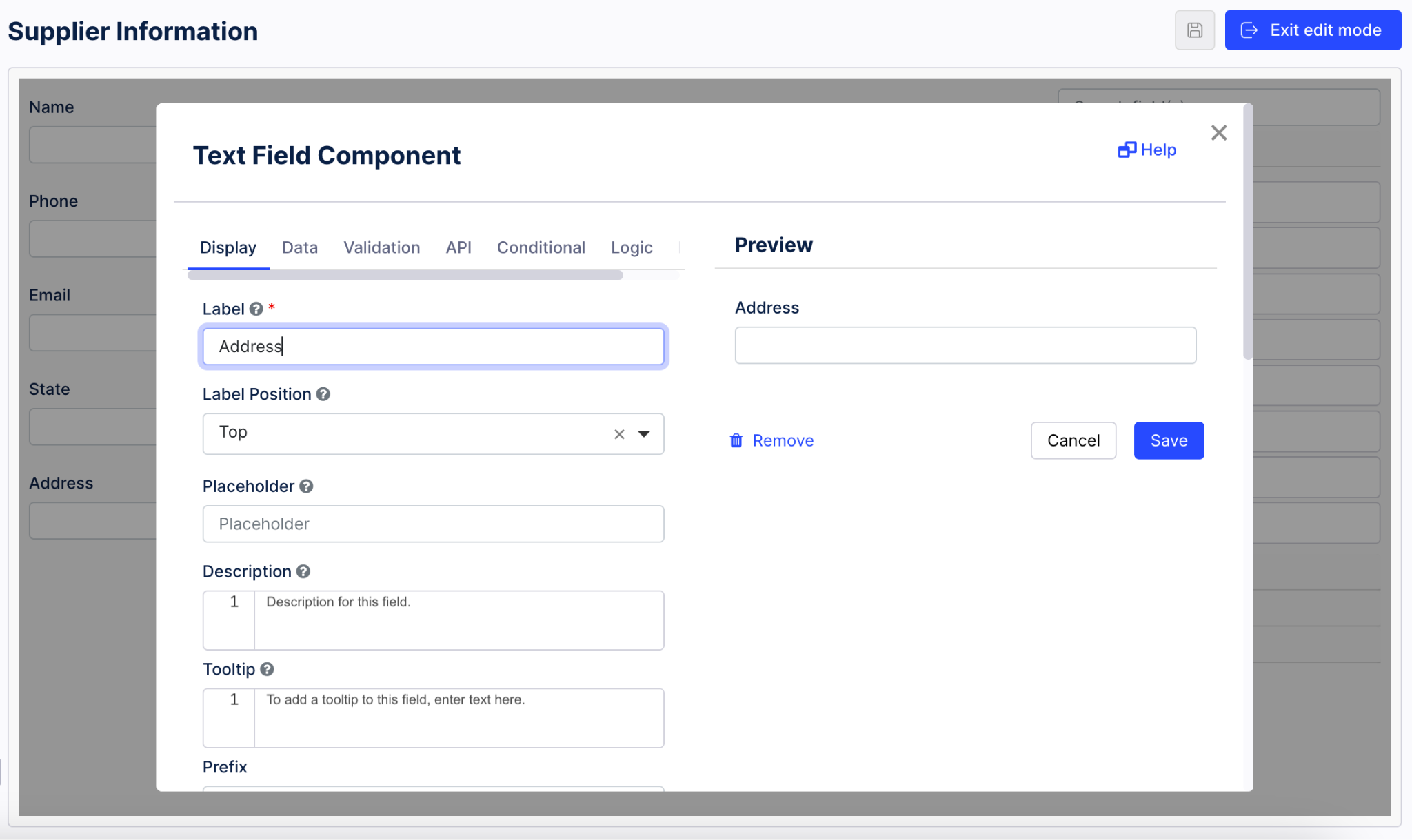

For every component that you add, there's a detailed view with the configuration settings for this specific field in the form. You can customize your component with different values, data or conditions.
For more details, see the Component Settings documentation.

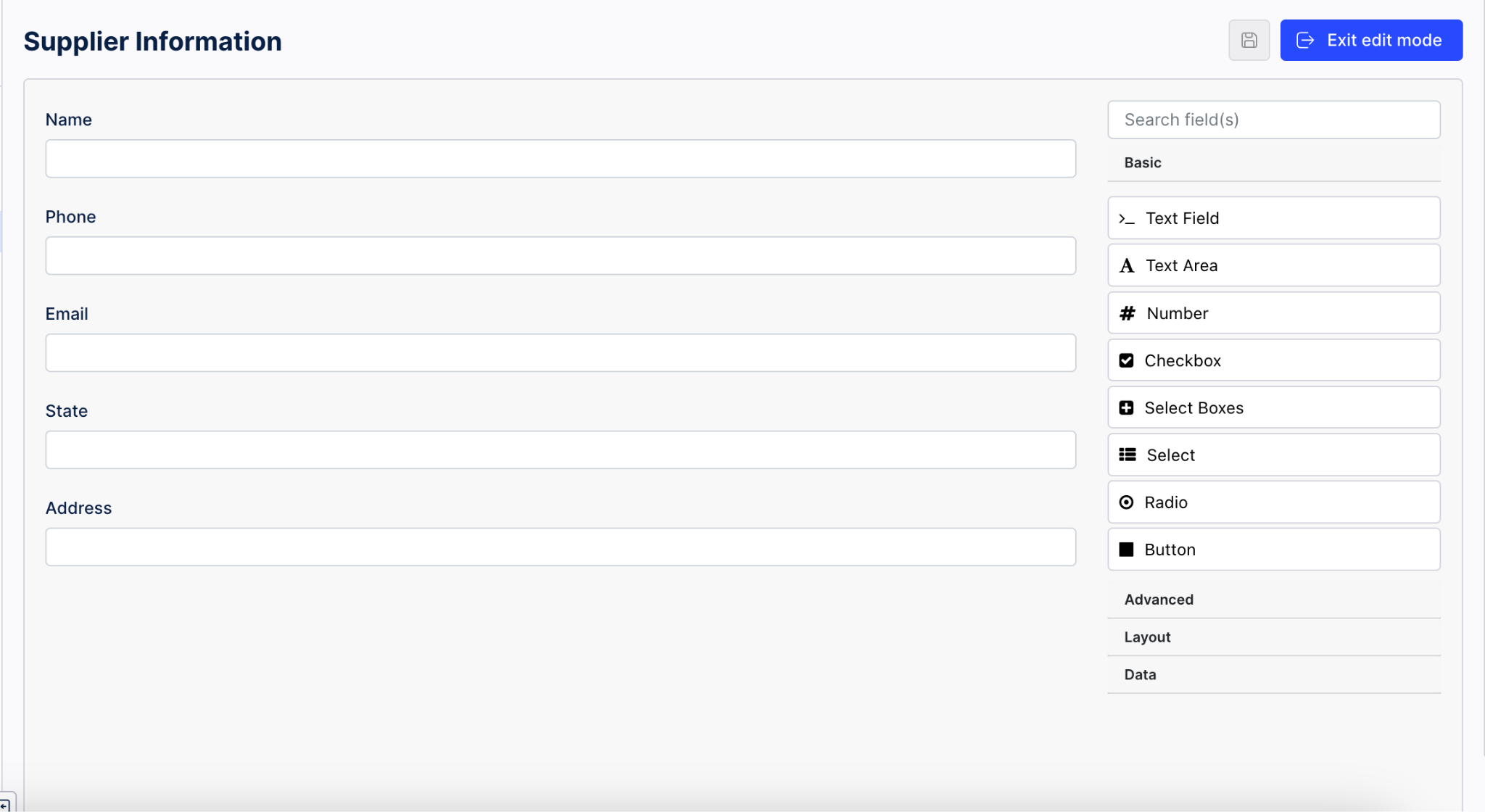

To preview the form after you've added all the components, exit the edit mode
Click Save Form.

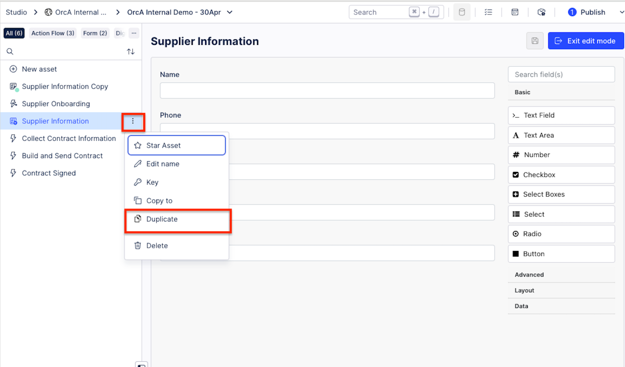

To duplicate an existing form, click the three dots next to the Form in the package asset list and click Duplicate.
Duplicated forms are added to the package asset list and displayed with the suffix "copy" in the form's name. You can then rename them.

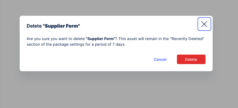

To delete a form, click on the three dots in the package asset list and click Delete. The asset will remain in the “recently deleted” section of the package settings for a period of seven days.
