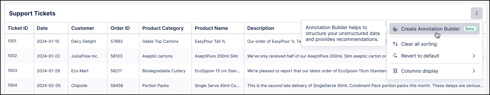

Create an Annotation Builder from a table
Annotation Builders can be created directly from a View table in Studio by clicking the options menu (three dots) above the table and selecting the "Create Annotation Builder" option. This will create an Annotation Builder that is specific to the data in that table with the inputs automatically mapped to the tables columns.
Screenshot of a Studio view with the table options menu open and the Create Annotation Builder option selected.
Selecting this option launches the Create Annotation Builder window that is used to create an initial configuration for this new Annotation Builder that can be modified as needed. The Input Data section of the configuration is completed by mapping the existing table columns as inputs. These connections will be completed automatically but can be modified as needed. The description of the use case entered on the Create Annotation Builder screen will be analyzed by AI to create the initial system prompts for how this Annotation Builder will function and set the expected outputs created by the analysis.
  1. In Studio, open the View containing the table you want to use to create the Annotation Builder.
  2. On the table, click the options menu (three dots) in the header and select “Create Annotation Builder”.
    Screenshot showing the "Create Annotation Builder" menu option in a Studio View table.
