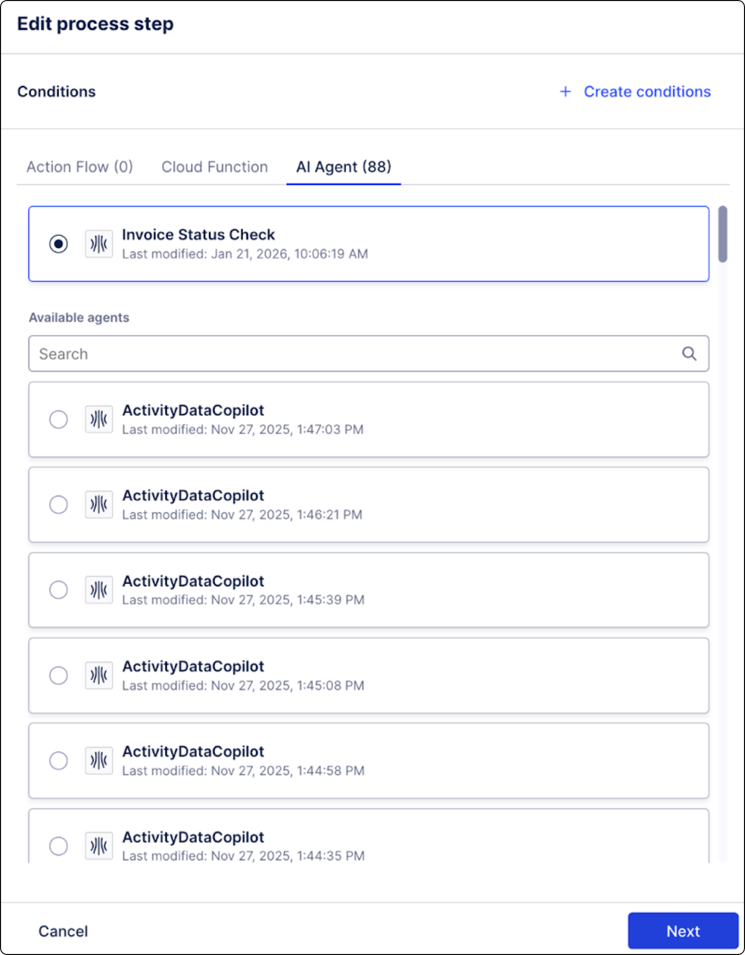

  1. In the process step editor, select the AI Agent tab.
  2. From the list of available agents, select your Process Copilot instance.
    Process Orchestration step editor with the AI Agent tab selected.
  3. Click Next.

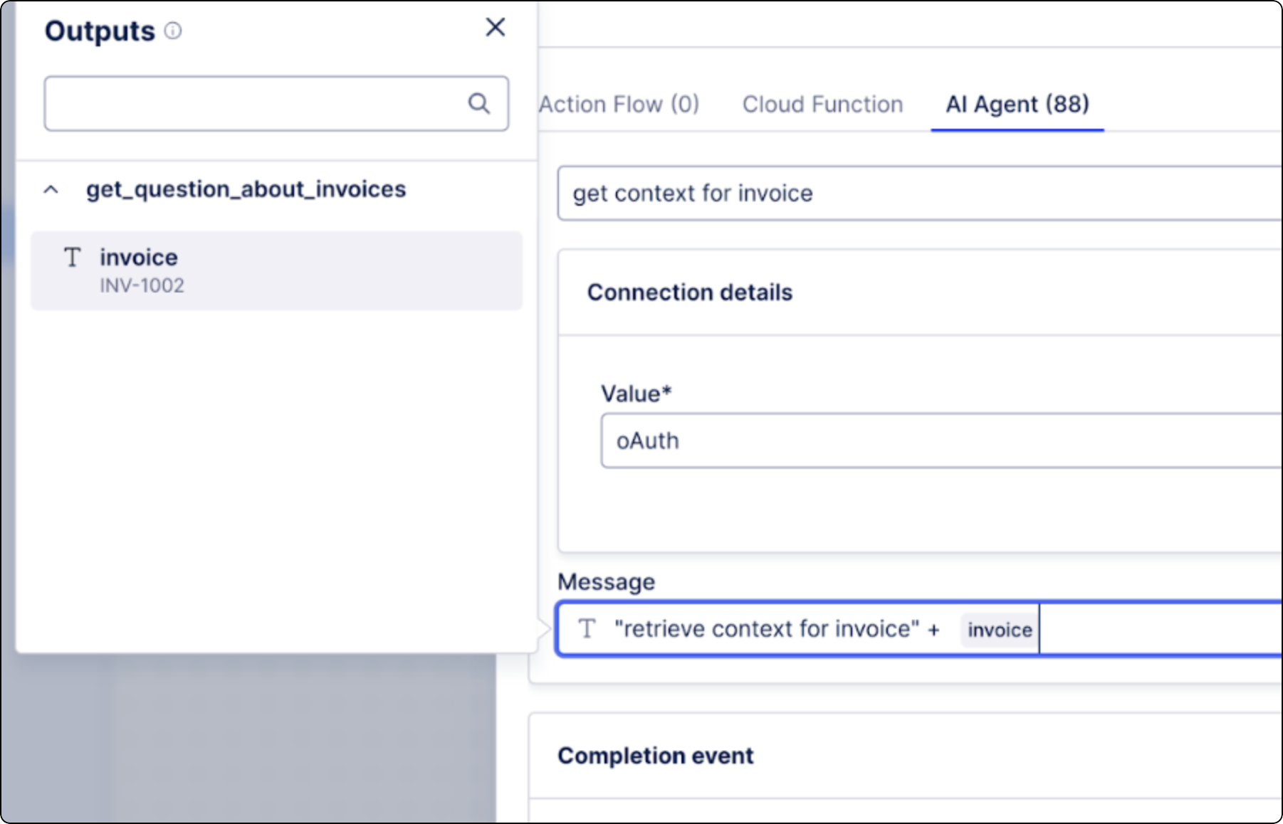

  5. In the Message field, enter the text of the message you want to send to Process Copilot you previously selected.
    • The text in the message field needs to be enclosed in double quotes.
    • You can use variables in the message. Use the ‘+’ symbol to connect the variable to the string text.
      Edit process step modal for an AI Agent in Process Orchestration, with the Outputs popover open. A dynamic invoice variable from a starting event is being appended to a text string in the Message configuration field.
    • If you’ve never tested this Process Orchestration instance, you may not see variables yet. Variables appear after the first test run.
