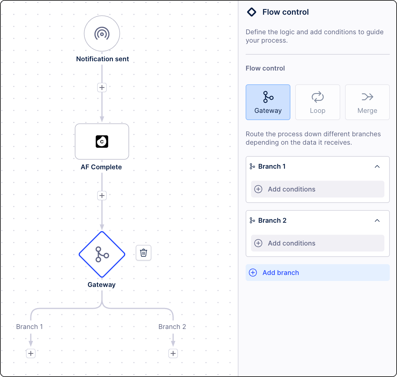

  1. In your Process Orchestration, select the + icon > Flow control.
    Right now, this area only allows you to add Gateway as the only flow control mechanism. However, other flow control mechanisms are coming soon.
  2. From the side panel, select Gateway.
    Process Orchestration with the Flow control side panel open and the Gateway option selected.

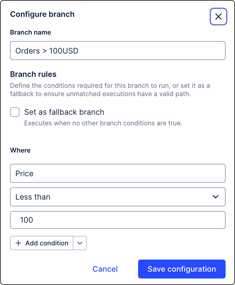

    Gateways allow you to define conditions that will guide your process through specific flows depending on the criteria you set. For example, you want to set a purchase order request to different approvers depending on their value; orders below 100USD should go to person A and orders above 100USD to person B. By default, two branches are created for you. You can add more if needed.

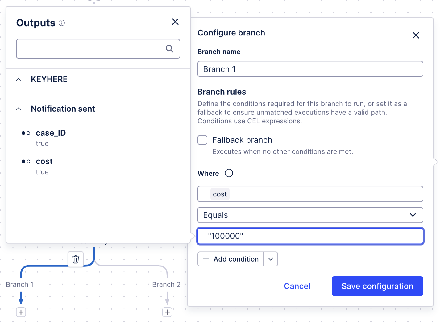

  3. From the Flow control panel, select the first branch to define conditions for routing the orchestration through it:
    1. Give your branch a distinct name.
    2. (optional) Decide if you want to make this a fallback branch. A fallback branch is the default branch to use when conditions specified in other branches can’t be met. For example, in the purchase order flow, this could be a branch where invoices with errors, like missing PO numbers, go to.
      You can only have one fallback branch in your Process Orchestration.
    3. Define conditions for this branch.
      There are a few things to consider before you start creating conditions:
      • Condition rules for Process Orchestration branches only accept Common Expression Language (CEL) format. Here are some basic rules for creating expressions in CEL. For Celonis-specific examples, see CEL expressions. For more information on CEL, see cel.dev.
        • Static text must be wrapped in double quotation marks (“ “). For example:
          request.payload.status == 'APPROVED'
        • Values not wrapped in double quotation marks (“ “) are treated as variables.
        • You use context variables from other steps in this field. When you start defining your condition for the first time, there is no output you can reference. You must start a test run to see the values available for mapping. Alternatively, you can map these values manually using the following:
           contextEventPath("event-name:property")

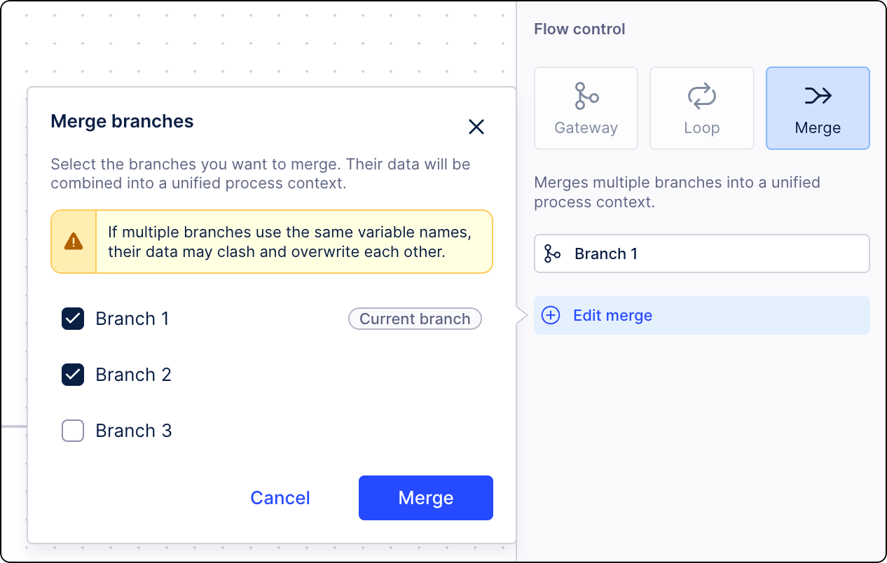

Merging conditional branches allows you to combine two or more flows in your orchestration into a single branch.
You can only merge sibling branches. You can’t merge branches coming from different gateways.
  1. Select the first branch you want to merge. Click the + icon > Flow control.
  2. From the side panel, select Merge.
  3. From the Flow control panel, select Edit merge.
  4. Select the branches you want to merge and click Merge.
Your conditional branches are now merged. You can continue building orchestration. When you’re done, we recommend testing your setup.
