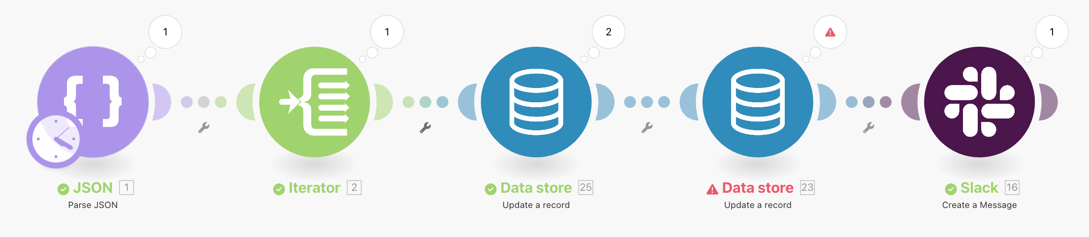

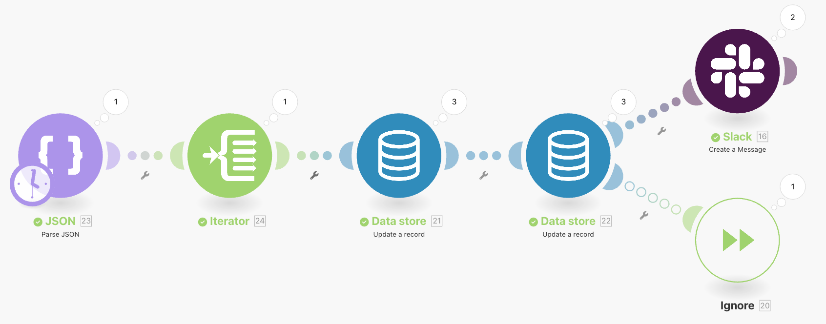

If we added the Ignore error handler to the Update a record module, the Ignore error handler would remove the bundle from the Action Flow flow. The bundle doesn't enter the fifth (Send a message) module. The third bundle runs through the Action Flow:

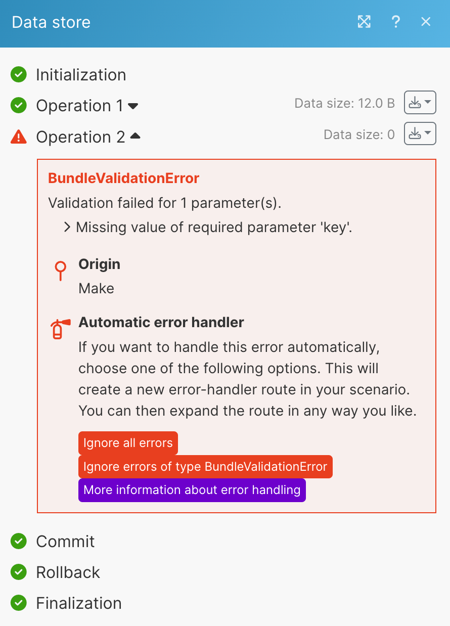

For example, the following Action Flow outputs an error in the Update a record module:

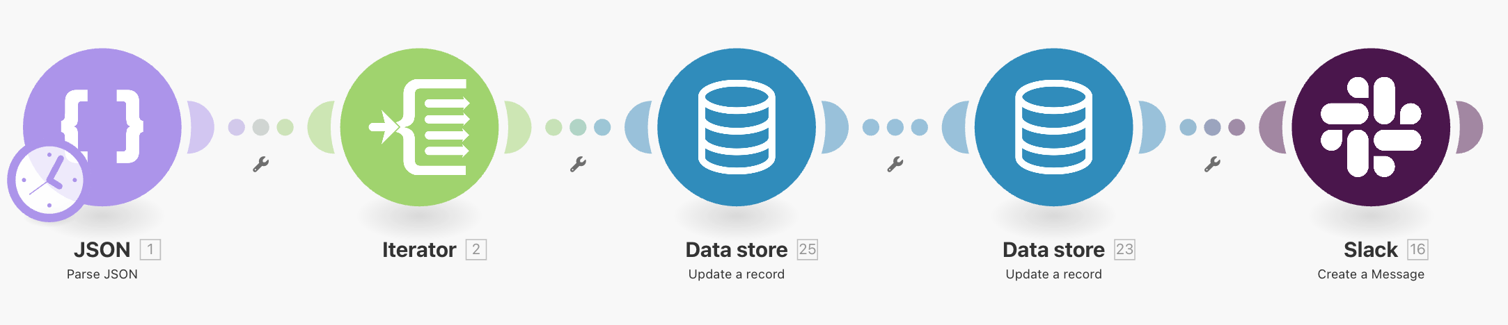

To ignore the error and keep your Action Flow running regardless of errors, follow the steps:

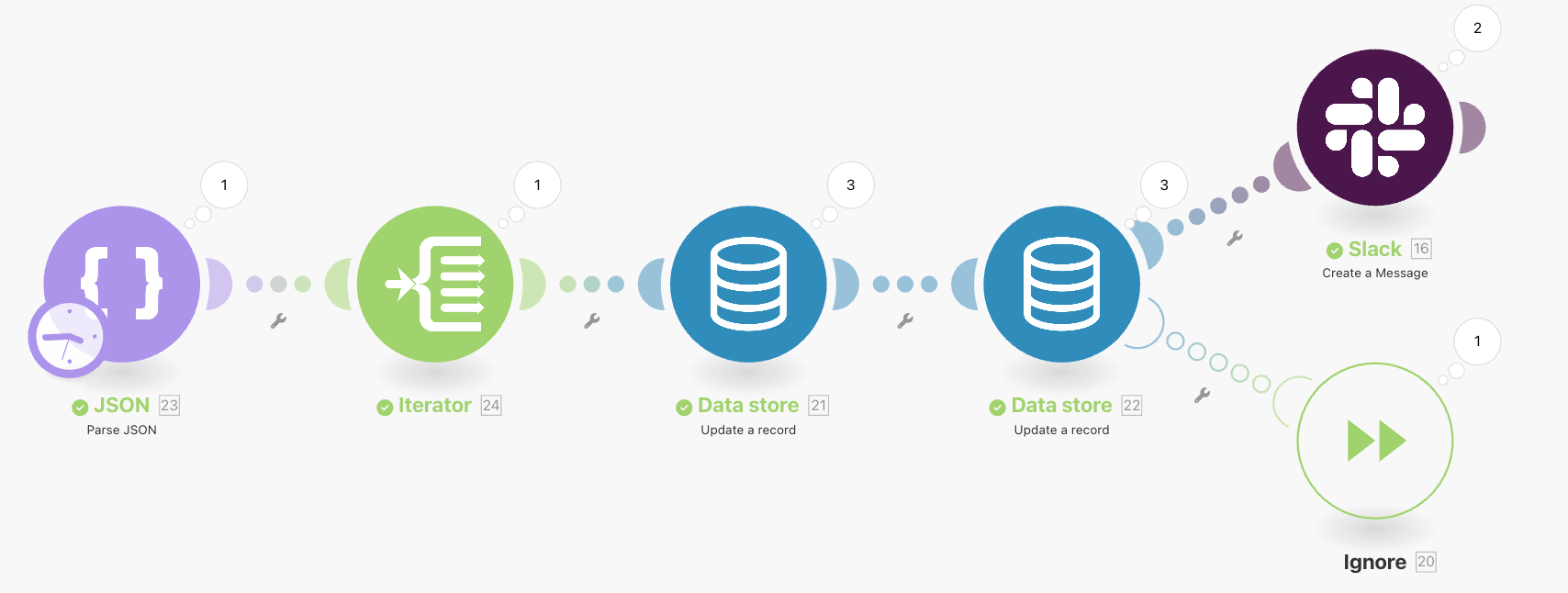

  1. Right-click the module that is causing the error. In the menu, select Add error handler.
  2. Select the Ignore error handler.
  3. Save your Action Flow.
Your Action Flow keeps running regardless of errors. When an error occurs in the Data store module, the Ignore error handler removes the bundle from the Action Flow flow.
