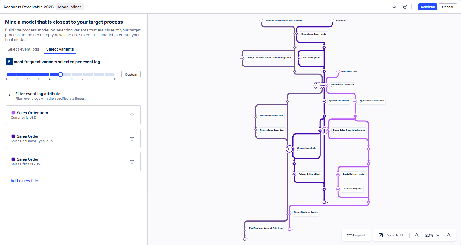

Using filters to set the data scope of your baseline model lets you focus on specific parts of your process or aspects of your process like a country or specific product. Any filters you apply here will be automatically applied to your target model when you create it. You can edit or remove these filters at any time. For more information, see Filtering the process model.

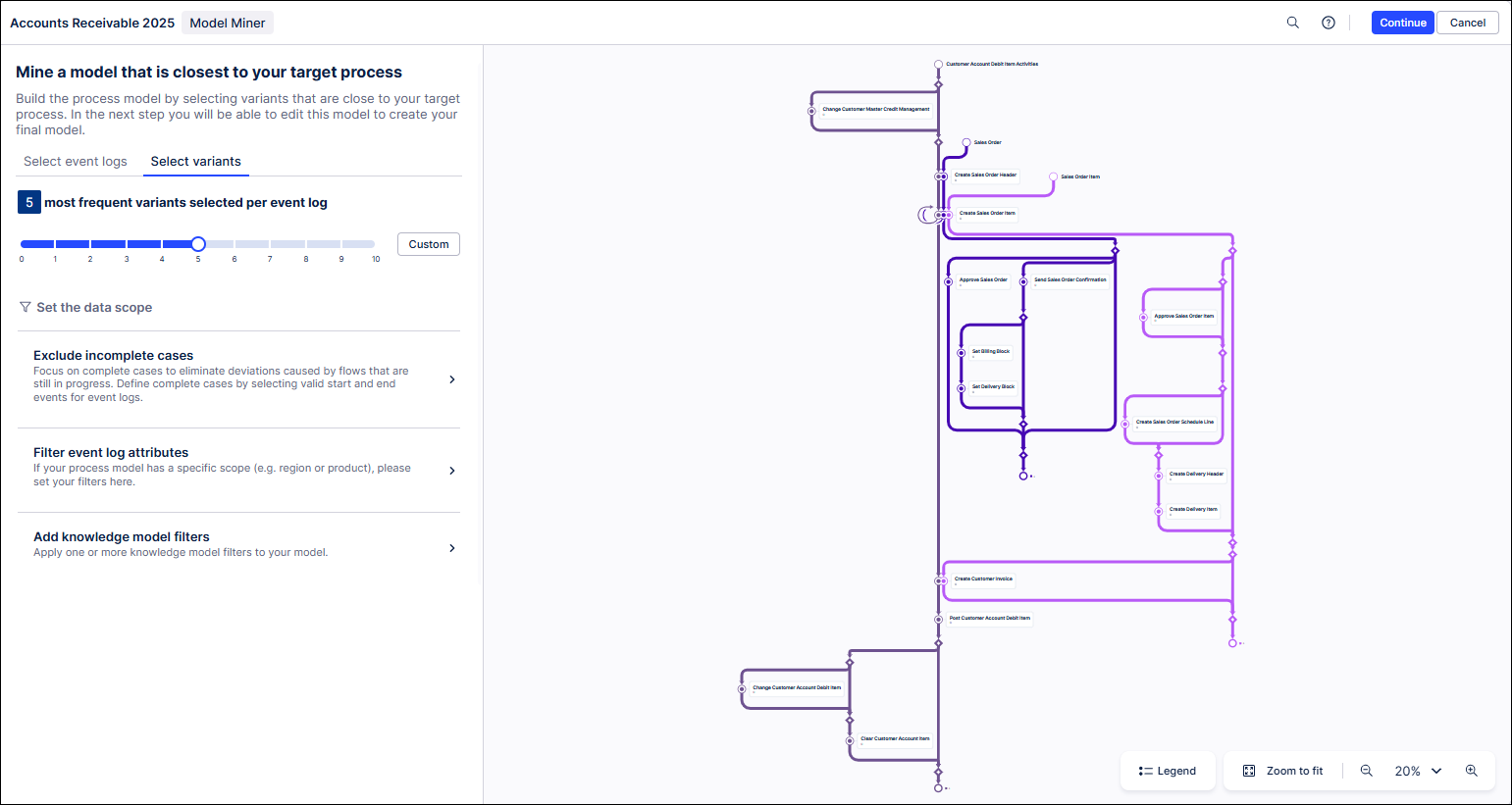

  2. In Model Miner, select the Select variants tab.
    Model Miner screen displaying the model variants.
  3. Select Exclude incomplete cases and, if you want to focus on a specific part of the process, specify start and end events for individual event logs.
    We recommend you remove incomplete cases as they can add unhelpful ‘noise’ to your process.
  4. Include data for a specific aspect of your process, such as geographical area or creation date, using Filter event log attributes and Add knowledge model filters.
  5. Select Continue.

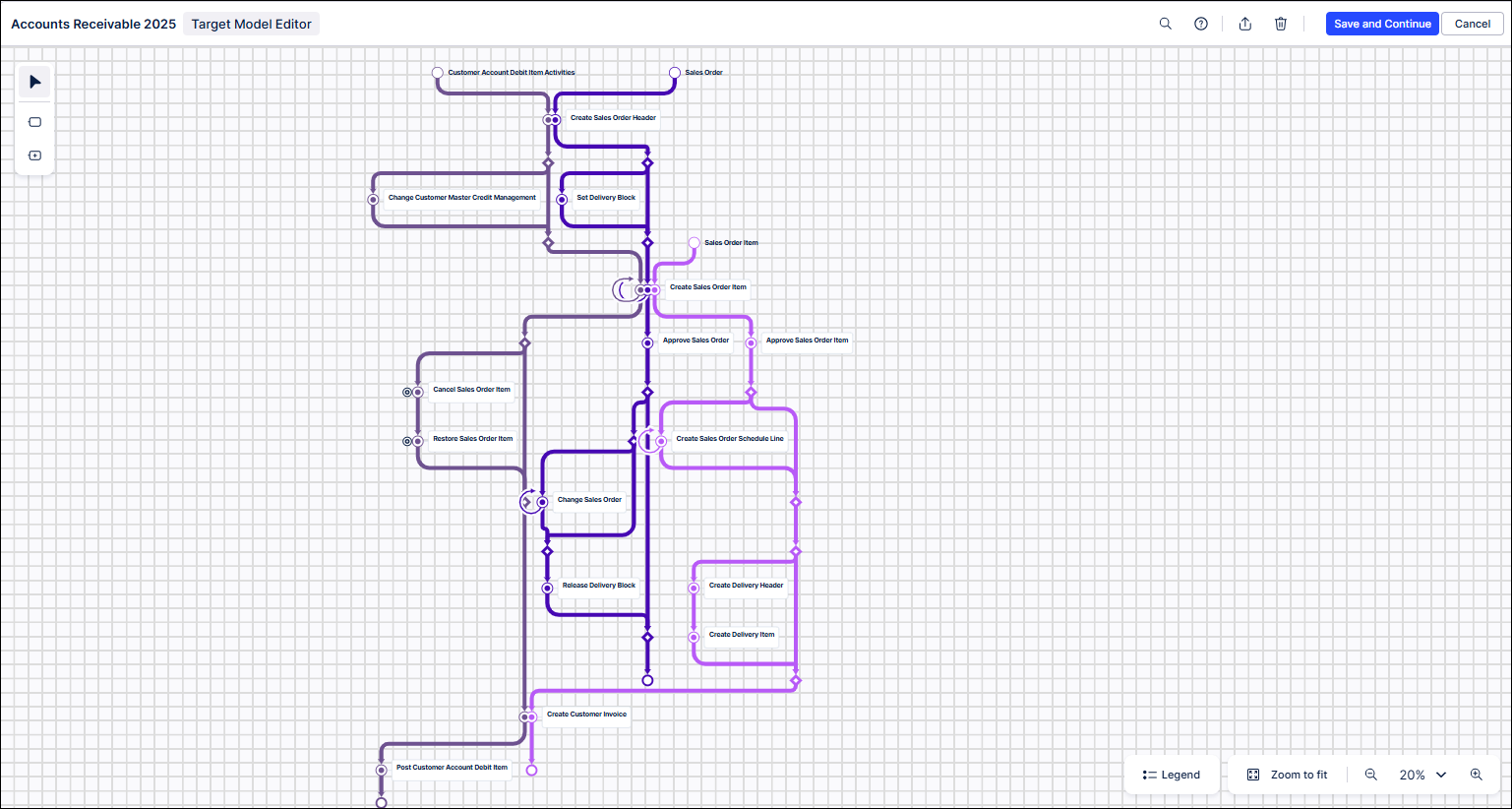

    Your baseline model opens in the Target Model Editor.
  6. Review and add variants.
