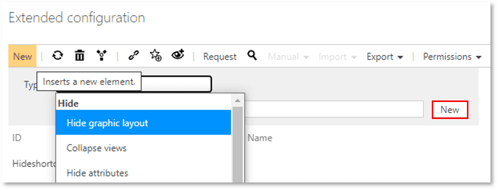

To use the advanced configuration, please proceed as follows:
  • Navigate to the Admin area and click the Extended configuration tile.
  • Create a new type with one of the configuration options Hide, Rename, Add or Change.
The next sections describe these configurations in more detail.
NOTE: To apply all changes, the configuration has to be activated by click on check box and additionally applied afterwards.

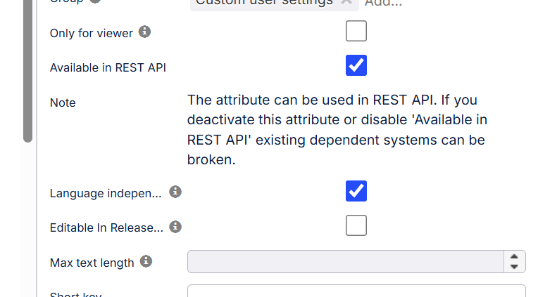

  4. By activating “Only for Viewer” this custom attribute will only be displayed for the viewers
  5. By activating "Available in REST API", this custom attribute will be available in Process Navigator.
  6. By activating Searchable this attribute will be considered in the Celonis Process Management standard search.
  7. By activating “language independent”, this attribute will be for every language and can´t be translated.
  8. By activating Editable in Released state, this attribute may be edited even afterwards in released state. We recommend to enter a Max text length, otherwise the default length of 81 characters will be automatically set.
  9. To apply all changes, the configuration has to be activated and applied afterwards.

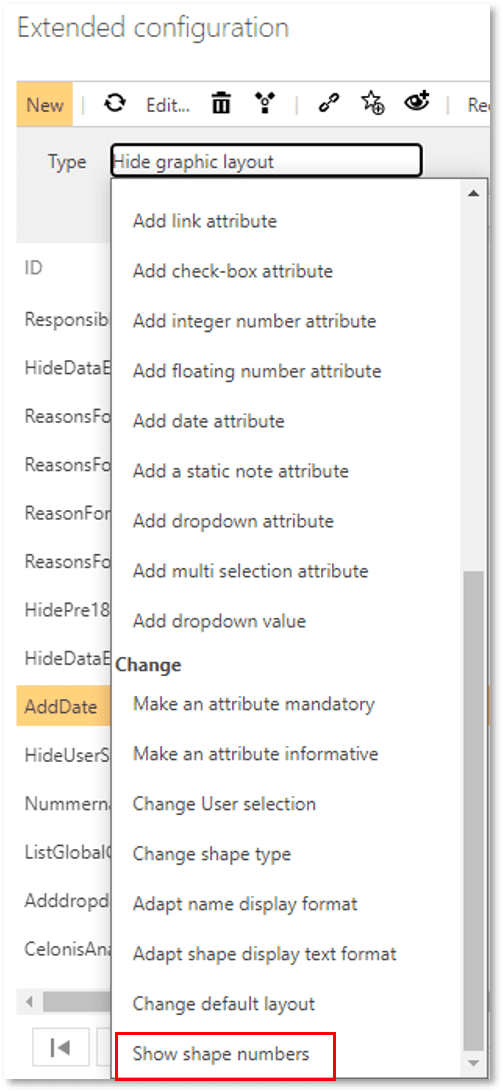

Generally, the default layout for processes is Vertical. If you like to change this, you can set your individual default layout here. This is also applicable for further facets, e.g. Organizational units, where you can choose between Graphic/Detailed view.
Show shape numbers
This setting is a prerequisite for using the Feature __Method: Numeration of process flow objects__that allows to display shape numbers on shapes in different graphical views.
Please add a new type Show shape numbers in the Change section and, in the Detail Content, select the layouts for which it should be applied.
After configuration, the feature activation will follow.
