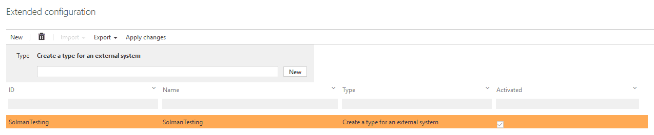

Go to the Administration menu and navigate to the “Extended configuration”.
Create a new Type for an external system.
For the settings, upload the SAP Solution Manager .syexfrom the XmlFiles/Bin folder of the service project. See the Versioning page to see which .syex file to use.
Important: Select the Activate checkbox and click the APPLY CHANGES button.

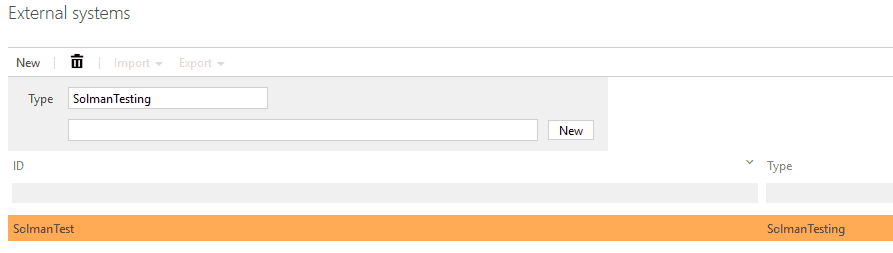

Go to the External Systems page.
Create an new instance of the external system type that you created in Step 3 above.

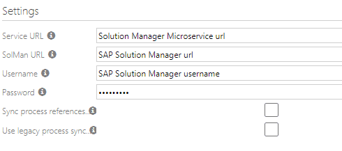

In the Service URL field enter the URL of the SAP Solution Manager Connector microservice.
In the SAP Solution Manager URL field enter the base URL of the SAP Solution Manager API.
In the Username field enter your username for the SAP Solution Manager API.
In the Password field enter your password for the SAP Solution Manager API.
You can select the Sync process references option. When sub processes are synchronized from Celonis Process Management to SAP Solution Manager this option will decide whether or not it will synchronize all sub process references and their diagrams as well. If this option is not enabled, the sub process references will be represented as empty sub processes in SAP Solution Manager.
You can enable the Use legacy process sync option. A sub process represents the SolMan process and its diagram. It is not permitted to maintain multiple diagrams for one SolMan process. Without this option enabled, multiple diagrams are possible on a SolMan process, each represented by a sub process.

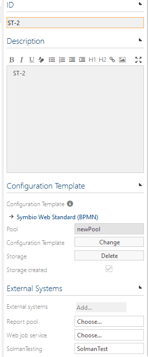

Create a Celonis Process Management storage.
Switch to Editor mode, go to Admin > Features and enable the "BestPracticeTasks" feature.
Go back to the storage collection and select your SAP Solution Manager external system for you storage. During this process Celonis Process Management will be linked to the microservice, and an auth token will be created.
