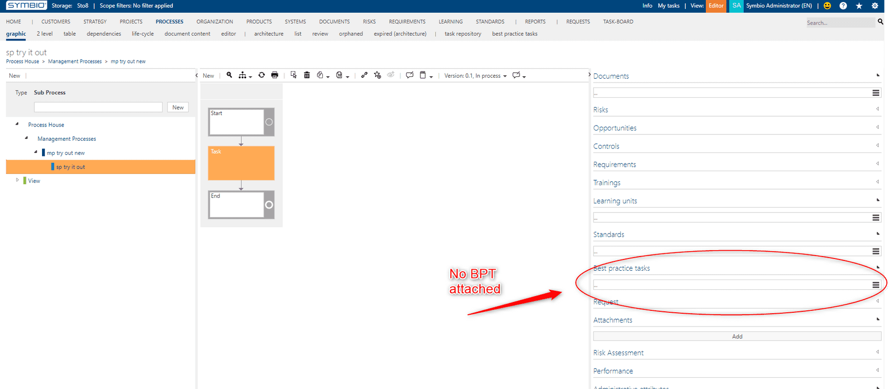

In Celonis Process Management you have an task that doesn’t have a best practice task attached.

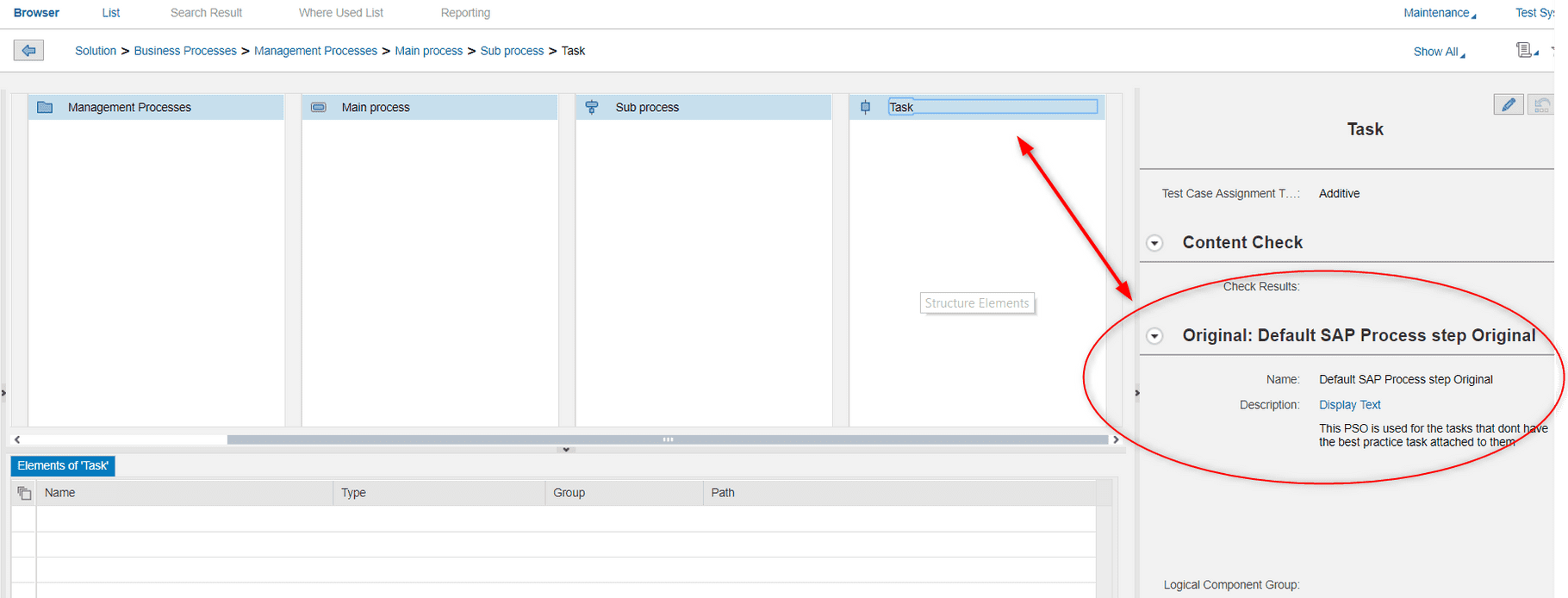

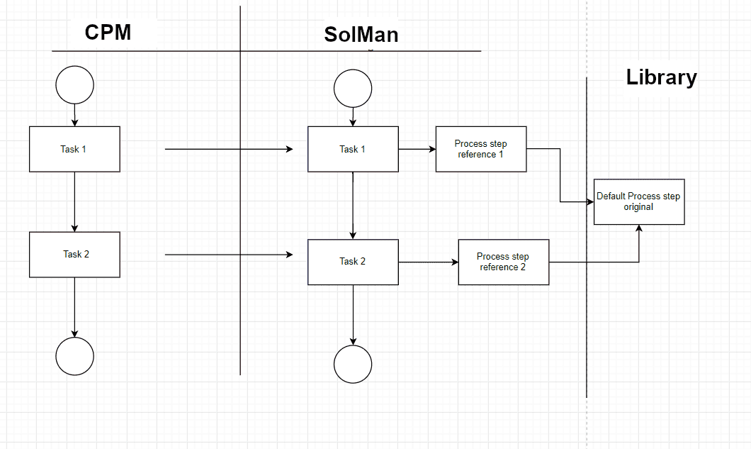

You want to synchronize this sub process to Solution Manager. When the synchronization starts the tasks that do not have the best practice task attached will be provided with a special Default Process step original. All the tasks that don’t have a best practice task will reference the same default process step original.
Below is a graphical representation of the synchronization:

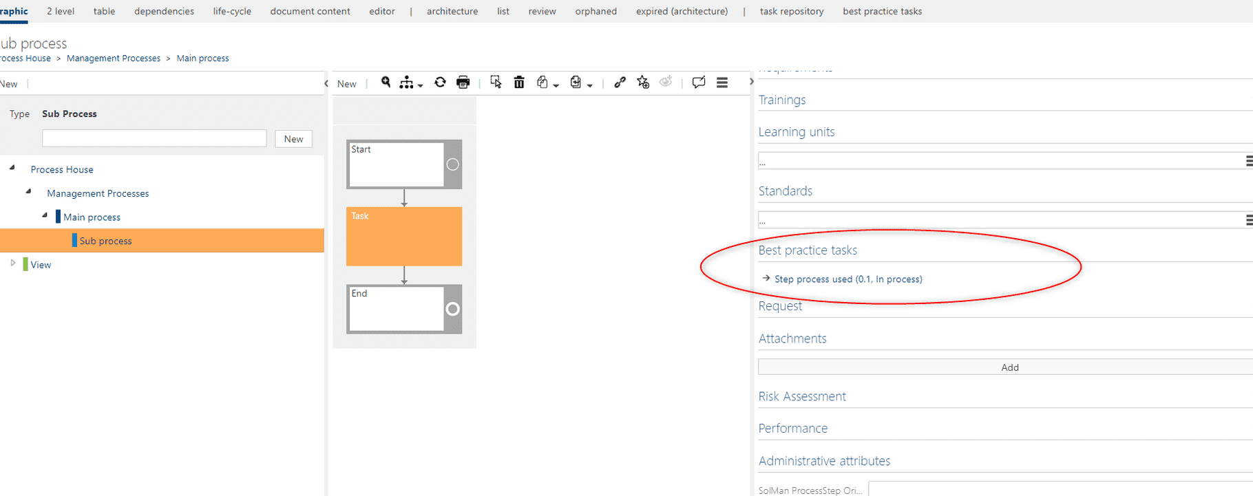

Case 1: Celonis Process Management user attached a Best practice task to a Task
A user in Celonis Process Management attached a Best practice task to a task. Then they synchronize this to Solution Manager.

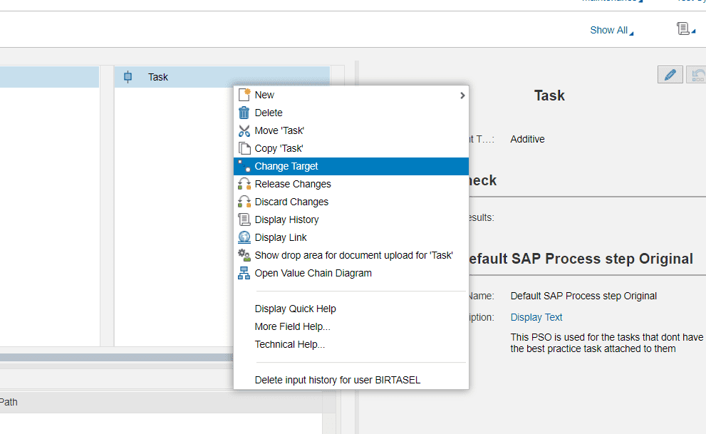

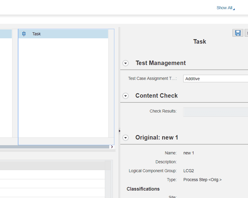

Case 2: SAP Solution Manager user attached a Process step original to a Task
Another user changes the target of the process step reference in Solution Manager and chooses a real process step original instead.

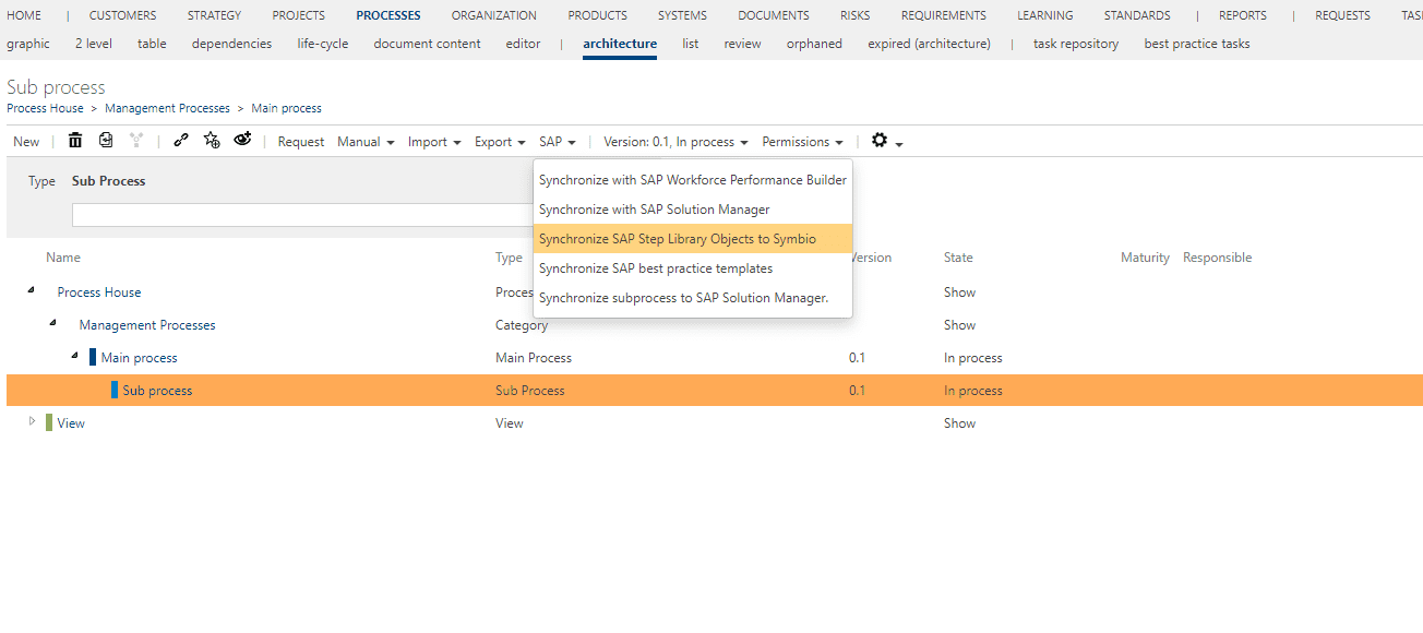

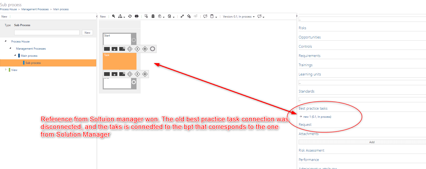

If the user wants to consolidate this back to Celonis Process Management, if they can click Synchronize SAP Step library Object to Celonis Process Management to look for the differences between the references of tasks from Celonis Process Management and Solution Manager. If there is difference the reference from Solution Manager will take priority.
Now the task will also have another custom attribute called SolMan Process step original id, that stores the ID of the SAP Solution Manager reference from the latest consolidation. Now if a user changes the best practice task attached to the task and tries to synchronize this to Solution Manager, it will fail. Now, when that task has been consolidated, it will not be possible to synchronize change of the reference to Solution Manager. If another user in SAP Solution Manager changes the reference and consolidates again, this will change the best practice task attached.
Important notice
If both sides of the references change, and the user doesn’t select the Synchronize SAP Step library Object to Celonis Process Management option to consolidate the change from Solution Manager to Celonis Process Management, then when synchronizing from Celonis Process Management to Solution Manager the Celonis Process Management reference will win. So if the user wants their changes to be consolidated to Celonis Process Management, they have to select that option or these changes will be lost the next time they synchronize a sub process from Celonis Process Management to Solution Manager.
