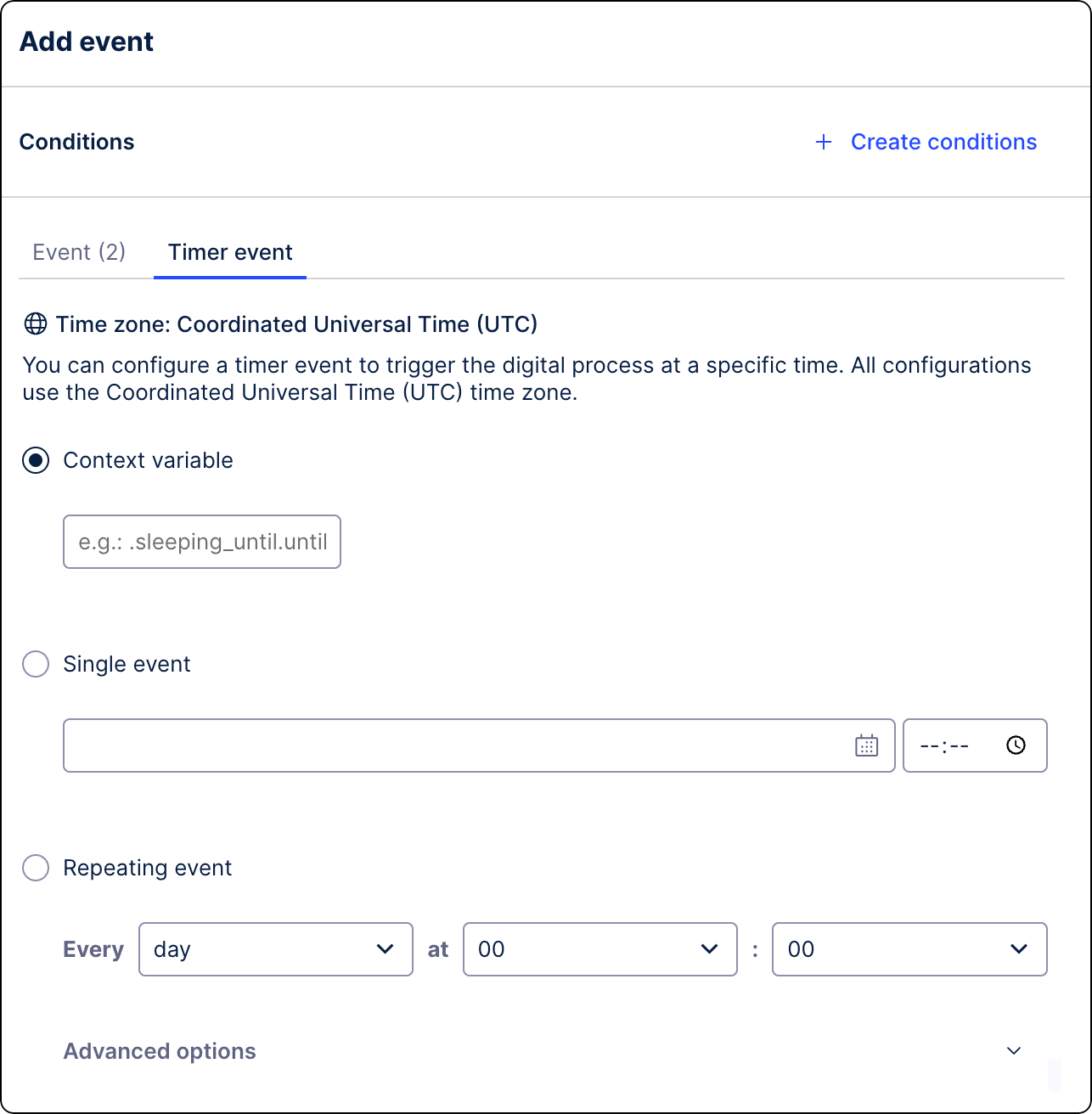

Process Orchestration even screen with the timer event tab open.
  5. Select how you want the process to be resumed:
    • Using context variable
      Use the variable stored in the Action Flow Process Context as information about when your Process Orchestration should be resumed.
      The variable must be configured in the following format:
      .sleeping_until.until
      where the wake-up trigger is the until property in the .sleeping_until event.

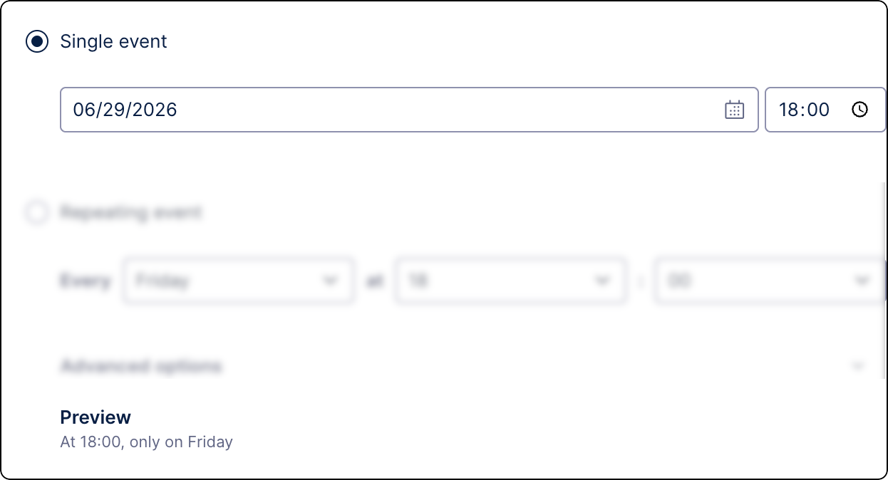

    • One time only
      • Select the date and time when the event should be resumed.
    • On a repeating schedule
      • Define recurring schedules using precise timing rules, such as every Tuesday, every 30 minutes or every month at a specified time.
