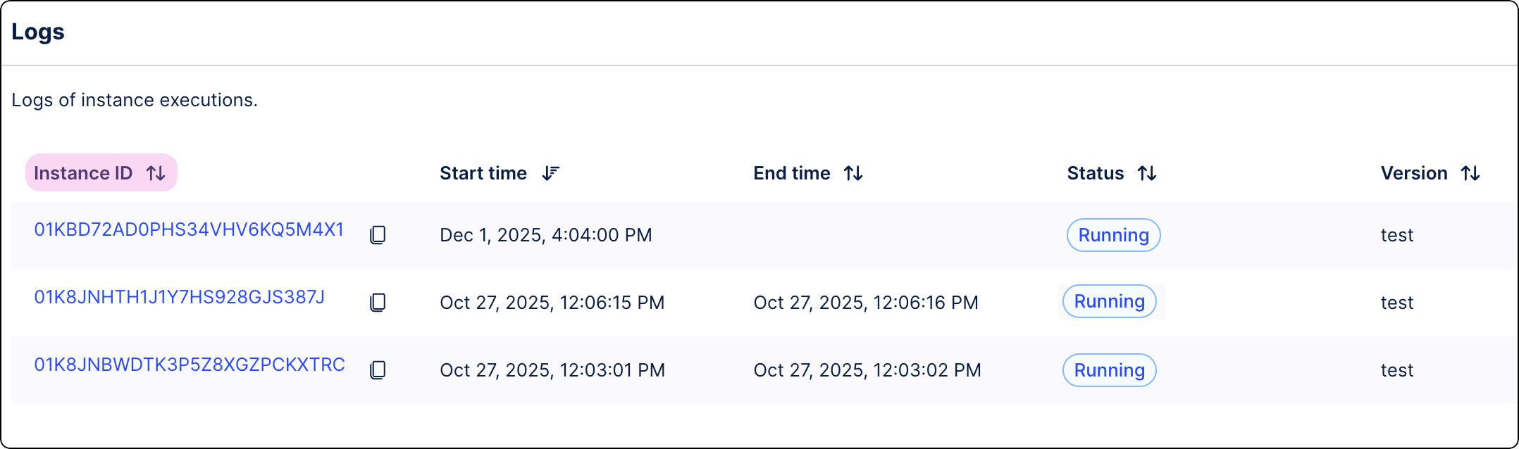

  • ce-instanceid - the ID of the Process Orchestration instance you want to resume. You can find the ID in Proce Orchestration logs.
