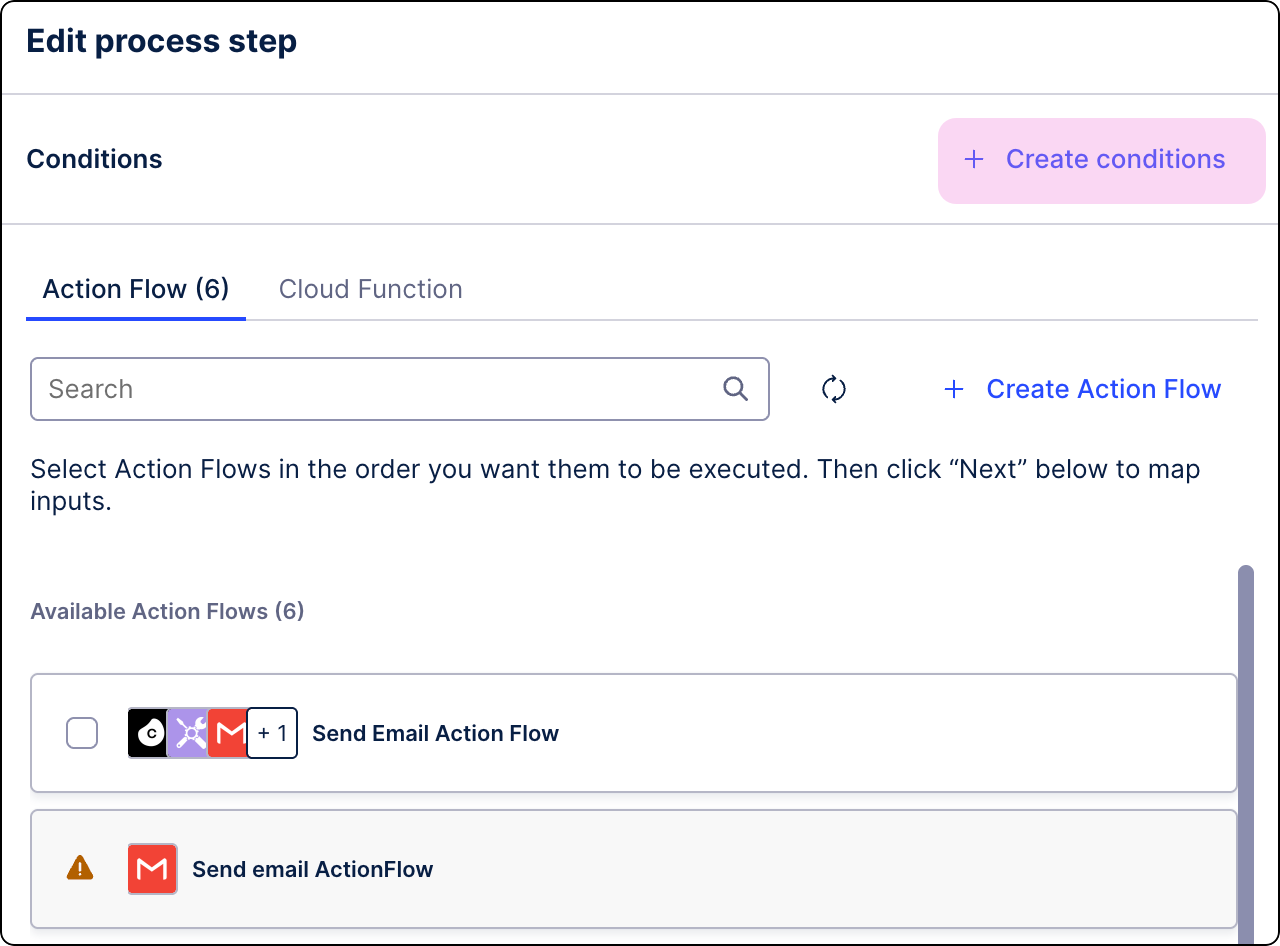

  1. In your Process Orchestration, edit one of the existing steps or add a new one.
  2. Select Create conditions.
    "Edit process step" interface showing a list of available Action Flows with the "Create conditions" button highlighted.
  3. Select the condition you want to set for your step:
    • Event filter -select one or more events that will start your process step. If none occur, the step is skipped.
    • Rule - create a condition using a JSON logic expression. See Rules for step conditions.
  4. Click Submit.
    The condition is added to the process step.
