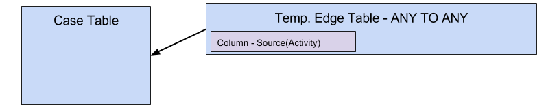

- SOURCE ( Activity, ANY_OCCURRENCE[] TO ANY_OCCURRENCE[] ) - SOURCEis called with the- ANY_OCCURRENCE[] TO ANY_OCCURRENCE[]edge configuration. A temporary edge table is created and the- SOURCEcolumn is added to it:

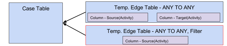

- TARGET ( Activity, ANY_OCCURRENCE[] TO ANY_OCCURRENCE[] ) - TARGETis also called with the- ANY_OCCURRENCE[] TO ANY_OCCURRENCE[]edge configuration. As this is the same configuration as in the previous- SOURCEcall, the- TARGETcolumn is added to the existing edge table:
- This column is added to a new temporary table, because the configuration is different to the previous ones: - SOURCE ( Activity, Filter, ANY_OCCURRENCE[] TO ANY_OCCURRENCE[] ) - SOURCEis called with a filter column configuration. The- Filtercould be a call to REMAP_VALUES as shown above. Although the edge configuration- ANY_OCCURRENCE[] TO ANY_OCCURRENCE[]is the same as in the calls before, the overall configuration differs because of the additional filter column. Therefore, a new temporary edge table is created, and the- SOURCEcolumn is added to it:
Multiple temporary edge tables can lead to problems if used within the same query. This happens if SOURCE and TARGET operators with different edge and filter configurations are used within the same query. The edge tables cannot be joined together by default because they do not have a common table. This behavior is described in Join functionality in more detail.
