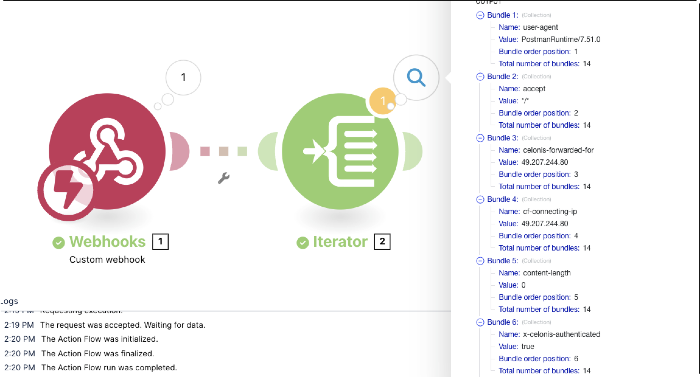

To access the webhook's headers, enable the Get request headers option in the webhook's setup:
You can then extract a particular header value with the combination of map() & get() functions. The example below shows a formula that extracts the value of the authorization header from the Headers[] array. The formula is used in a filter that compares the extracted value with the given text to pass only webhooks if there is a match.
See Mapping an array's element with a given key for further information on obtaining an array's element with a given key.
