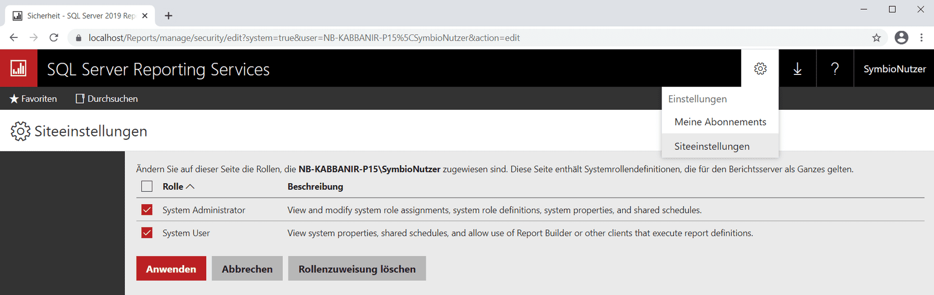

“The SSL connection could not be established” can be caused because the certificate of the website should be enabled. Therefore you may navigate to computer certificates, copy the certificate from Personal Certificates folder into “Trusted Root Authentication Authorities” and “Web Hosting”.
“Could not create SSRS workspace” can be caused by inappropriate assignment of rights to the user that have full access to the root folder of SSRS Reports; therefore, you can assign this user System Administrator Rights as well as System User Rights.

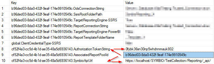

Connect to Report Connector Config Store.
Look for rows with a value equal to the noted ContextKey.
The key of these rows should be “some-id.AssociatedReportPoolId”.
Look for rows with keys corresponding to “some-id.SymbioApiUrl” and “some-id.AuthorizationTokenString”.
These should match the URL of the Celonis Process Management storage and the noted token ID.

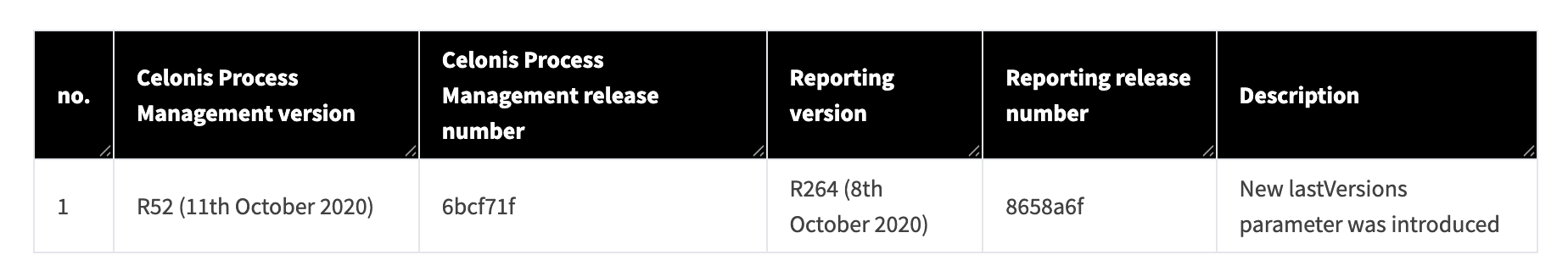

Which versions are compatible?
Celonis Process Management should be compatible with Celonis Process Management Reporting Service.
The Celonis Process Management Reporting Service respectively the ODS database created by it has to be compatible with the reports deployed.
To learn which versions are compatible, see the tables below. The given versions are the first versions after a breaking change, i.e. all versions equal or higher than that mentioned in a breaking change row are compatible until the next breaking change.
Breaking changes in the interface between Celonis Process Management and the Reporting Service:

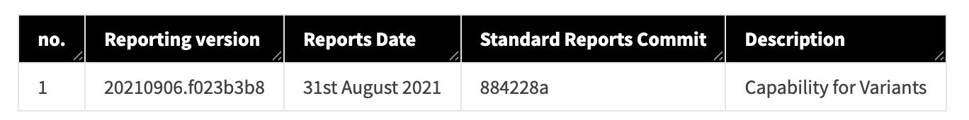

Breaking changes in the interface between the Reporting Service / ODS database and the reports:
With “reports” here we address standard reports as well as customer reports. That means if you deploy a new version of the reporting service including a breaking change you have to deploy all used reports as well. And vice versa, if you deploy a report (e.g. a bugfix in one report) including a breaking change, you have to (re-)deploy the reporting service and all other reports in that systaddem, too.
