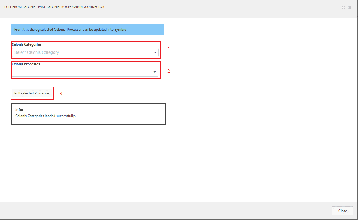

If the dialog is loaded successfully, your view should look similar to this:
You can now select the processes you want to transfer into Celonis Process Management:
1. Use the Celonis Categories dropdown to select the processes you want to transfer into Celonis Process Management.
2. Based on your selections, the selected processes will be loaded in the Celonis Processes field. - Note that it is possible to select multiple processes from the same category simultaniously.
3. Once you have selected the processes you wish to import, click Pull selected Processes button. 4. The service will start importing the processes from Celonis into Celonis Process Management.
5. Once the import is finished, a green notification will display in the upper right corner. After closing the dialog, you can find the imported processes in the selected subprocess or scenario.
