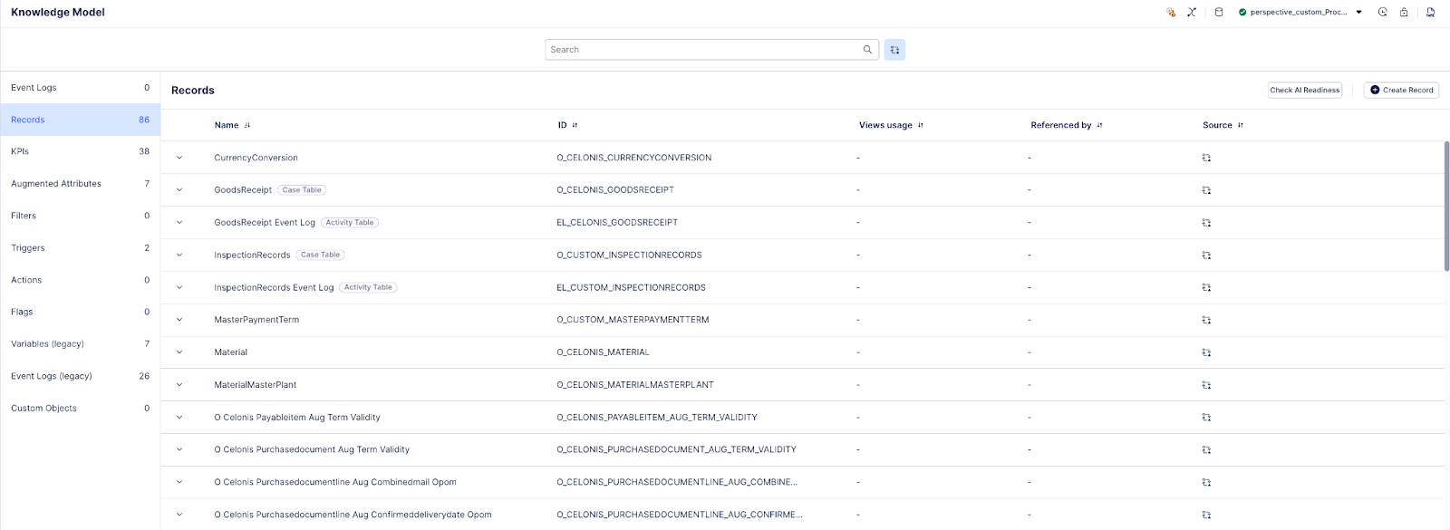

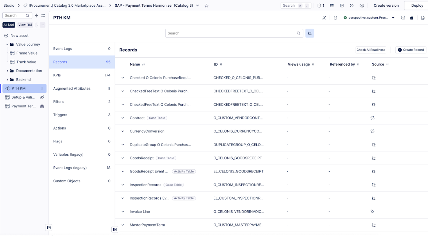

  2. In the Studio overview, find the SAP - Payment Terms Harmonizer (Catalog 3) app in the space where you installed it, and click its tile.
  3. Select the Knowledge Model from the app navigation.
  4. Select the KPIs section of the Knowledge Model to work with KPIs, or the Records section to work with calculated attributes.
  5. You can sort and search the KPIs using their name or ID. The prefix to the ID shows what type of component they are. At the end of this topic, we’ve listed the important KPIs that you can only manage in the Knowledge Model, and the most important calculated attributes for the app.
  6. To see and edit the full PQL formula and other settings for a KPI or calculated attribute, click its row to open an editor. The editor automatically validates any changes that you make in the PQL formula.
  7. If you want a fuller-featured PQL editor that lets you select from the tables and columns in your data, click on the pen icon next to the PQL formula.
  8. If you need to disable a KPI or formula, click the three vertical dots at the top of the editor, and select Disable Scope, then click Disable to confirm. When you do this, the object can't be accessed or used anywhere in the package, including by other apps that depend on it.
  9. When you’ve made changes to the KPIs and calculated attributes, use the Publish button at the top of the screen in your Studio space to publish a new version of the app.
