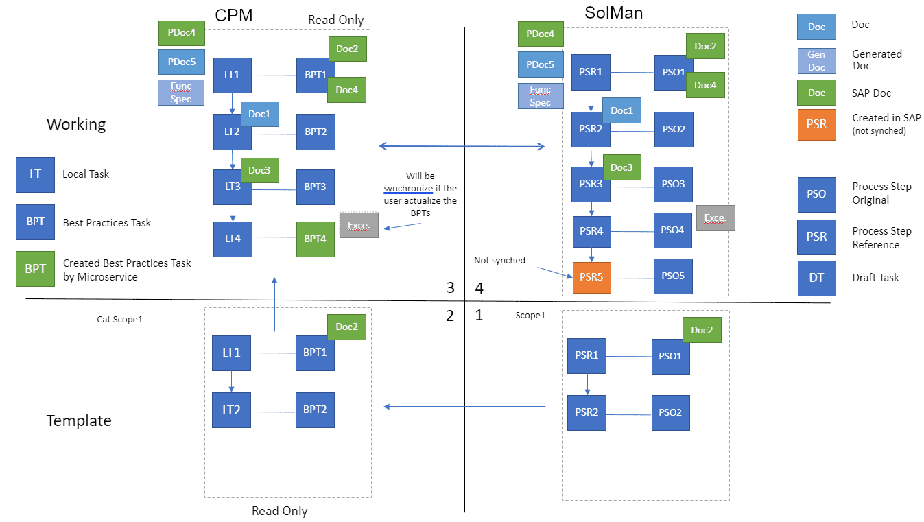

The recommendation is to use interface following the synchronization process that contains of four steps:
Synchronize the SAP Best Practice template processes from SAP Solution Manager to Celonis Process Management
Copy processes to specific processes in Celonis Process Management
Edit processes to best suit your needs
Synchronize modified processes back to SAP Solution Manager
The picture below represents the whole process in four steps:
1. Synchronize the SAP Best Practice template processes from SAP Solution Manager to Celonis Process Management
The first step is to synchronize processes from SAP Solution Manager to Celonis Process Management. You can synchronize either a small scope or the full process structure. These elements are read-only in Celonis Process Management. The main idea is that these processes serve as a template, so the user can edit them in Celonis Process Management and adjust to the actual company processes.
2. Copy processes to specific processes in Celonis Process Management
The second step is to copy the processes in Celonis Process Management from the SAP Best Practice package group to the dedicated companies processes. By copying these elements to the new processes, these elements become available for editing in Celonis Process Management.
3. Edit the processes to best suit your needs
Once you have your processes copied in to Celonis Process Management, you can now change them as needed. You can use Celonis Process Management to add new elements, edit the current ones, or remove some elements. You can use the library elements from SAP Solution Manager that can also be synchronized to Celonis Process Management, or you can add new elements that are created in Celonis Process Management. By doing so, you both adjust SAP Solution Manager processes and create your own process based on the SAP ones.
4. Synchronize modified processes back to SAP Solution Manager
Finally, when processes are edited and ready to be used, you can synchronize it back to SAP Solution Manager. If configured, this synchronization can occur on process release in Celonis Process Management or an architect can synchronize it manually.
