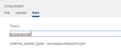

5. Click New and add a type for an external system named "ProcessPortalExporter".
6. Set the following attributes:
  • Name: Process Portal Exporter
  • Description: The exporter is used to make a backup copy of the data in Celonis Process Management.
7. Select the SYEX file under the settings data group with the Name: "ProcessPortal"
8. Make the external configuration active.
9. Click Apply changes.

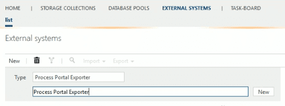

Add a configured external system linked to the active service
1. Click External systems on the main navigation bar.
2. Add a new external system with Type of "Process Portal Exporter"
3. Name the External System "Process Portal Exporter".
4. Add the URL for the instance of the microservice.

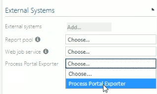

Connect the external system on the storage
NOTE: Only one storage can be connected to one instance of the service.
1. Go to Home and select the Storage Collection or create a new one.
2. Click Storages on the main navigation menu.
3. Choose an existing storage or create a new one.
4. In the External Systems group, select the configured external system from the Process Portal Exporter dropdown list.

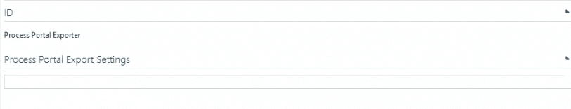

Result after adding the external system
Adding the external system to your repository will result in the following:
  • All the required configuration will be added to Celonis Process Management:
    Menu item to initiate the export
    Navigation elements
    Authentication token
  • The service connection and the required Authentication token will be stored on the Azure storage.
